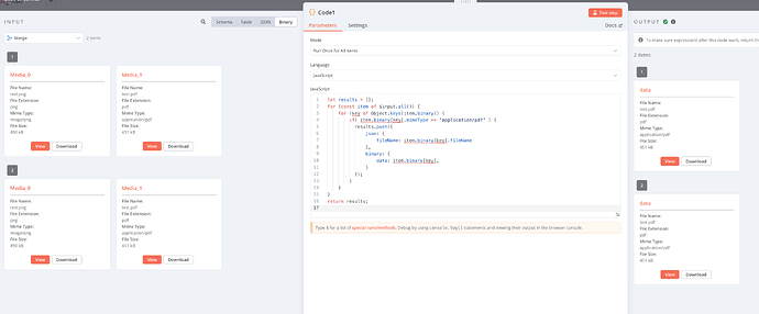

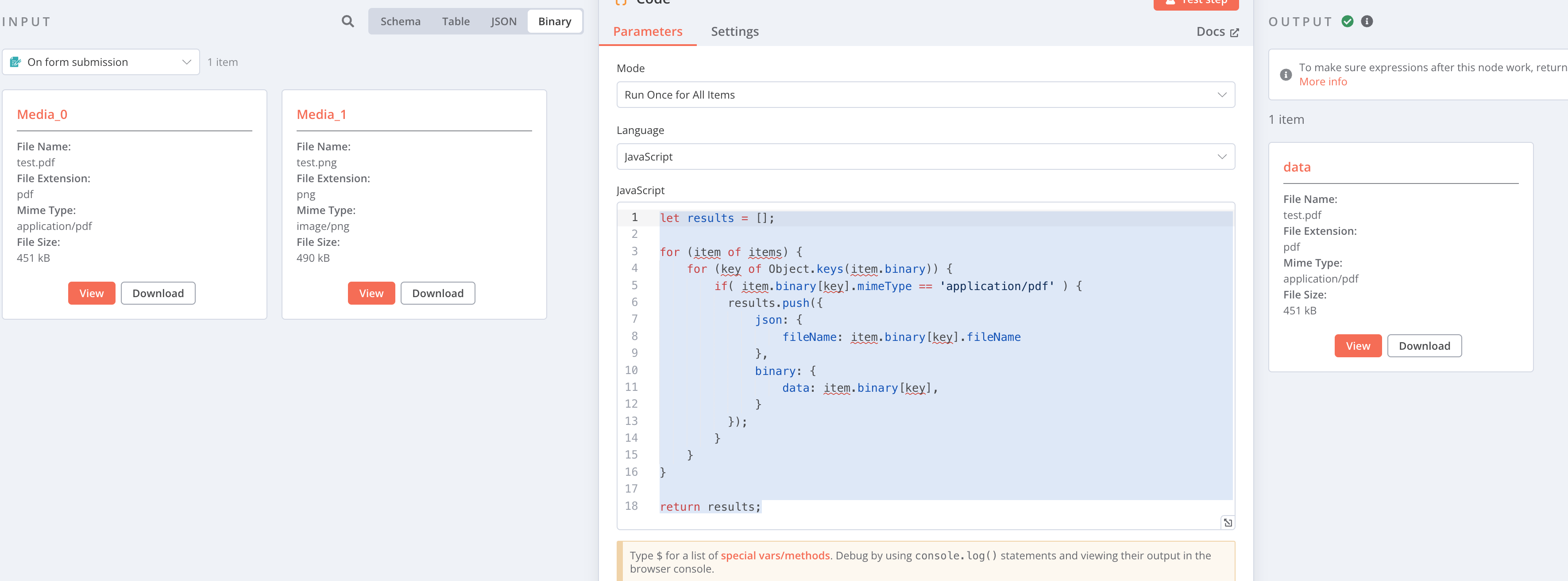

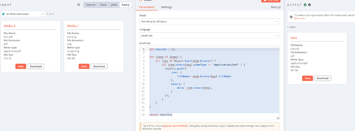

This example uses a form upload and a Code Node
In the code node you can filter the filetype pretty easily.
let results = [];
for (item of items) {
    for (key of Object.keys(item.binary)) {
        if( item.binary[key].mimeType == 'application/pdf' ) {
          results.push({
              json: {
                  fileName: item.binary[key].fileName
              binary: {
                  data: item.binary[key],
return results;
if you consider this to be the answer please click the ‘solution’ button

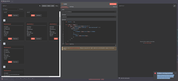

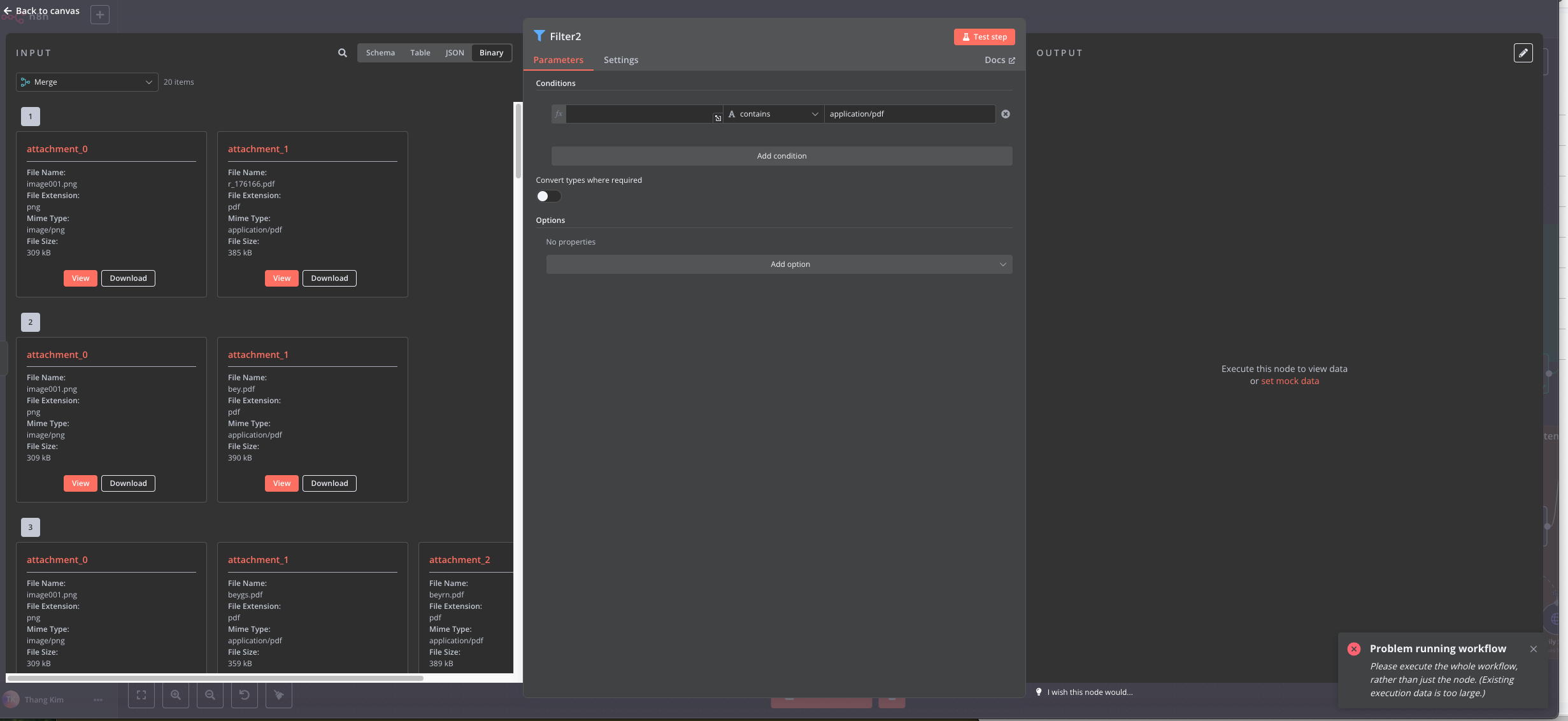

i tried but than get this error message
Problem running workflow
Please execute the whole workflow, rather than just the node. (Existing execution data is too large.)

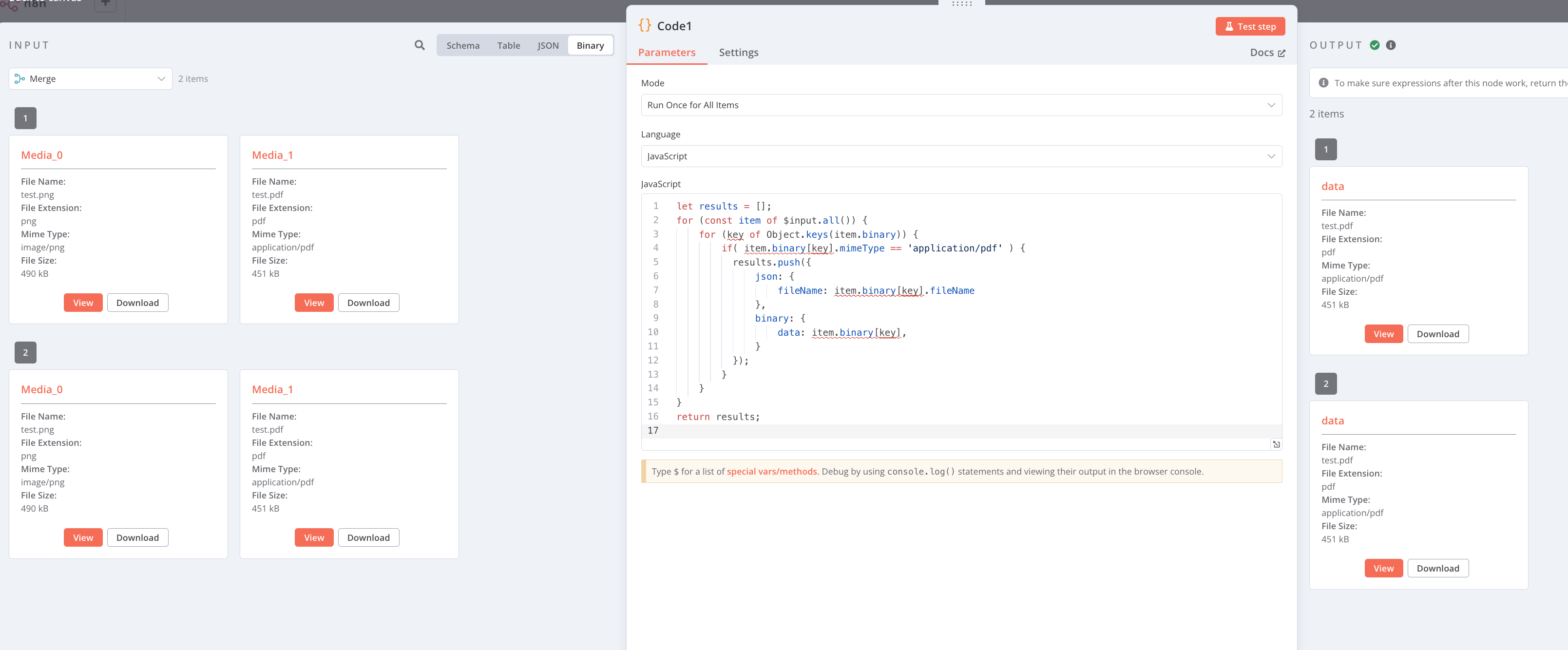

I checked using a merge node, the result is the same.
So it seems your problem is something else not related to my answer for filtering your input.
If you can show you wf we can have a look, you might have to much data in your browser, so re loading could be an answer.

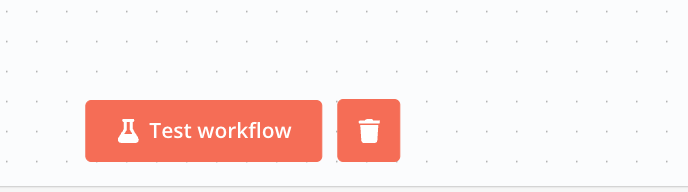

→ your execution data is stored in memory, If you don’t hit the bin/trash can icon at the bottom of the screen then often you can exceed the memory limits.
So, test the filter with fewer files and from there expand.
