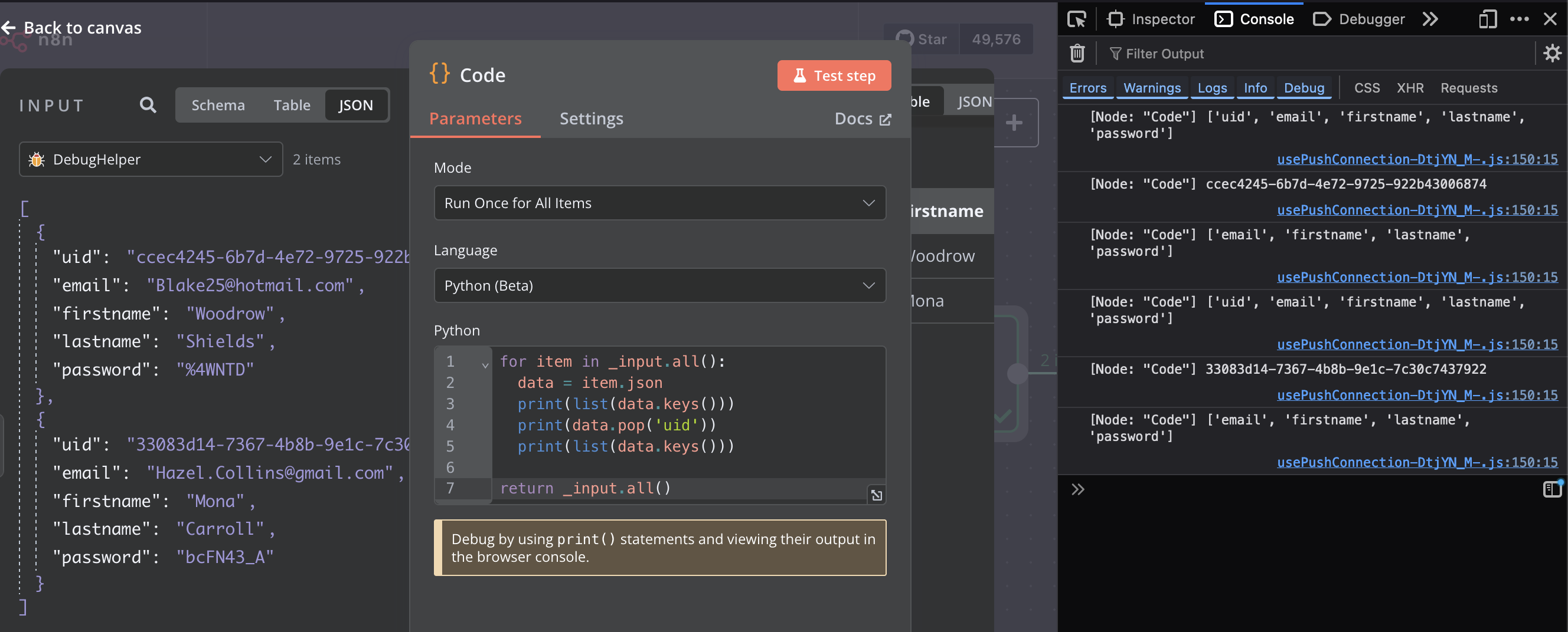

How can I use _input.item in python code
It appears _input.item is of type [Node: “Code”] <class ‘pyodide.ffi.JsProxy’>. How do I convert this to a python object that I can use in my code?
  • n8n version:: 1.68.0
  • Running n8n via (Docker, npm, n8n cloud, desktop app): :desktop app
  • Operating system:: Mac OS M4
Hey @PhilC , looks like working with items as dictionary does not require any special conversion.
Thanks so much @ihortom I think this is working. I’ll need to do some more testing, however.
After more testing, this works perfectly. Thanks so much for the response.
