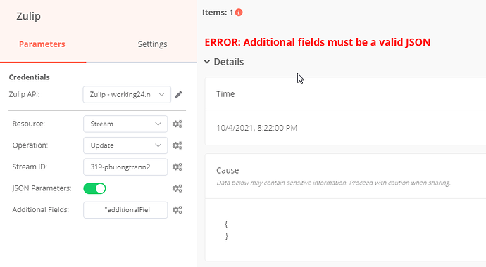

I try to use additional fields in Zulip node, but it says “wrong json”. Could you help me in correct json format for this?
This is my test:
With json content:
"additionalFields": {
"historyPublicToSubscribers": true,
"inviteOnly": true,
"principals": {
"properties": [
"email": "[email protected]",
Hi @cmdntd987, the JSON content appears to be missing some opening and closing braces. Does the operation work when using valid JSON in the field? E.g.:
"inviteOnly": true,
"principals": {
"properties": [{
It 's ok now.
But it does not not effect, like without json option… I think it could not update additional fields for stream update option, because of lack of API.
Hi @cmdntd987, I had a quick look at the Zulip API documentation on updating a stream. Have you tried using the exact field names in there? E.g. instead of additionalFields.historyPublicToSubscribers use history_public_to_subscribers like so?
"history_public_to_subscribers": true
I couldn’t find support for the other fields mentioned in the Zulip API documentation on updating a stream, so you might be right on this not being supported by their API.
Do not think the additionalFields key is needed there.
I solved this.
Just recreate, not update.
