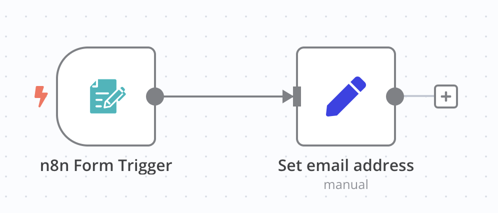

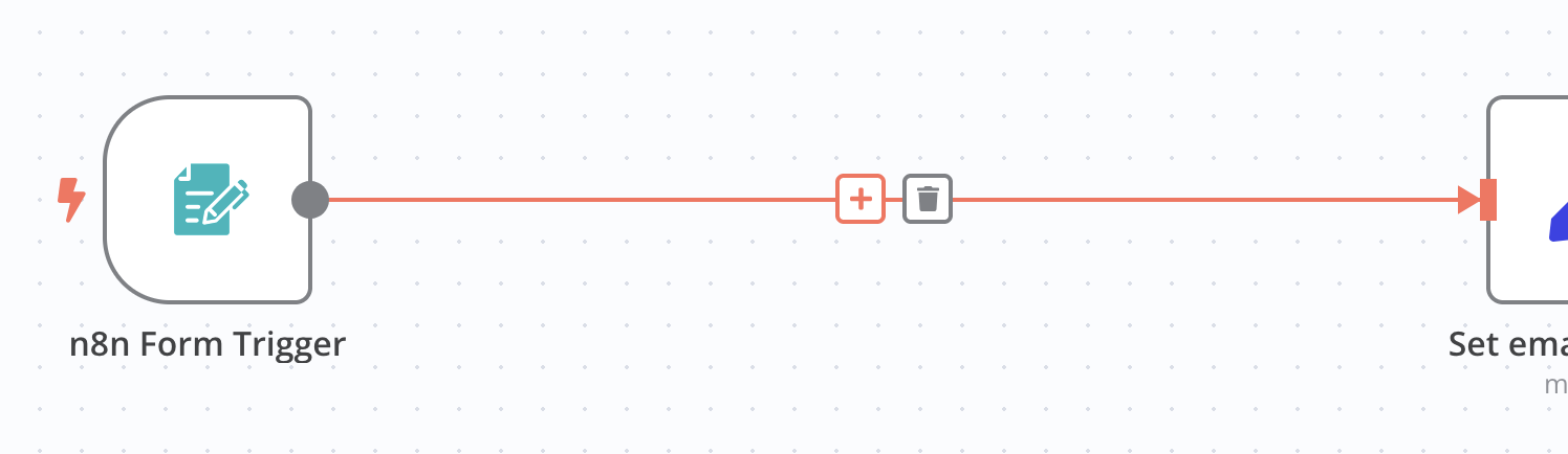

When I click the ‘+’ icon (in the line that connects nodes):
… a node is added:
… but when I press the ‘+’ again, instead of a node being added in parallel to the previous one, it is always added to the tail of the workflow.

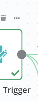

I figured it out. I have to create a connection by dragging the ‘dot’:
Screenshot 2024-10-27 at 11.41.16
… to a node. Which makes sense, but the behaviour of clicking the ‘+’ icon (as described in the OP) is non-intuitive.

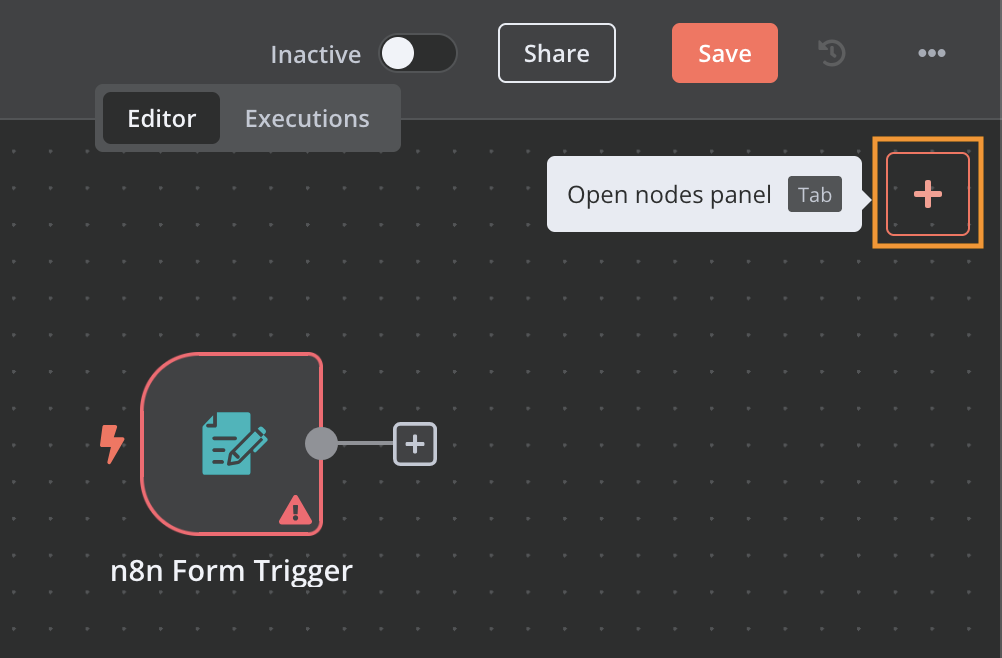

Use the “+” on canvas itself to add the node on its own and then connect the two nodes by dragging the output of one to the input of the other.
