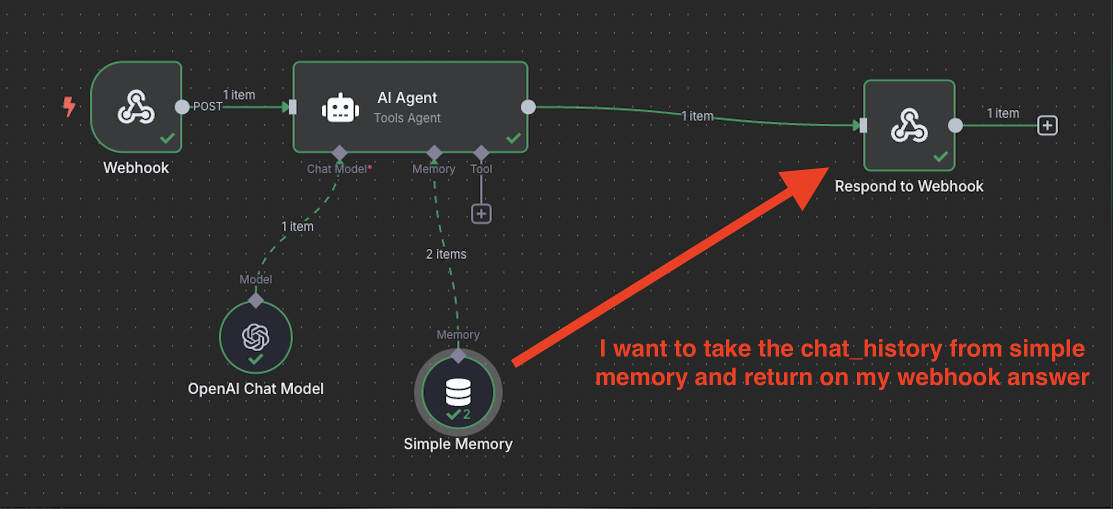

How do I capture the chat_history memory object (returned below) from my AI Agent simple chat node and output it on my AI Agent Output?
I need to implement a PostqgresSQL to do it?
I tried to capture it from global {{ $vars }}, but I didnt found it.
the object output from chat I want to output on my Agent answer:

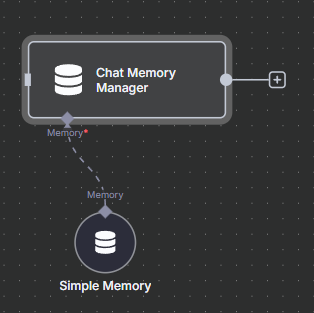

You probably need to use the Chat Memory Manager node to get the history..
I’m so sorry but I can’t parse Simple Memory as Json

I think it will cause error because Memory Node have to have a Trigger function.
But you can see there I no arrow from Trigger to Memory Node
ps: Look like you edited the photo, I think that OK.

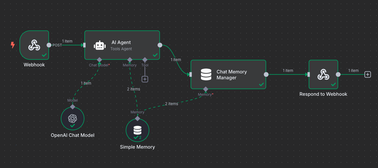

here is a working sample as a guide
Hi @NangAnhIUH you can use the Chat Memory Manager node with postgres as well, just link it instead of the simple memory in the sample above…

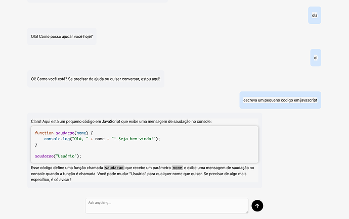

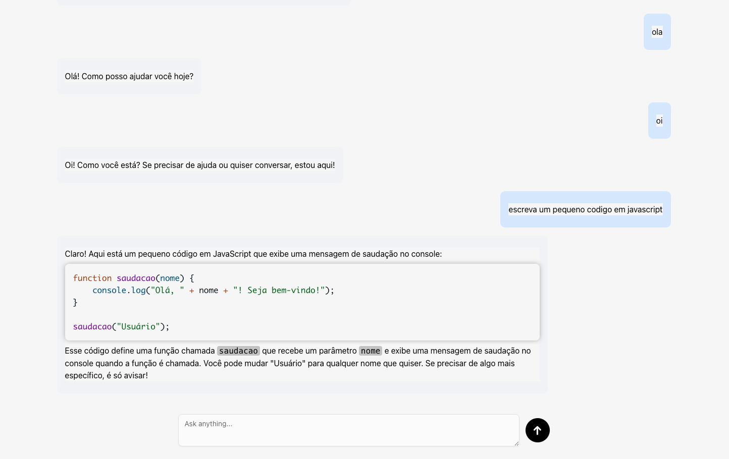

This one looks simpler because need only one DB, and works for me:
the result on my frontend:
