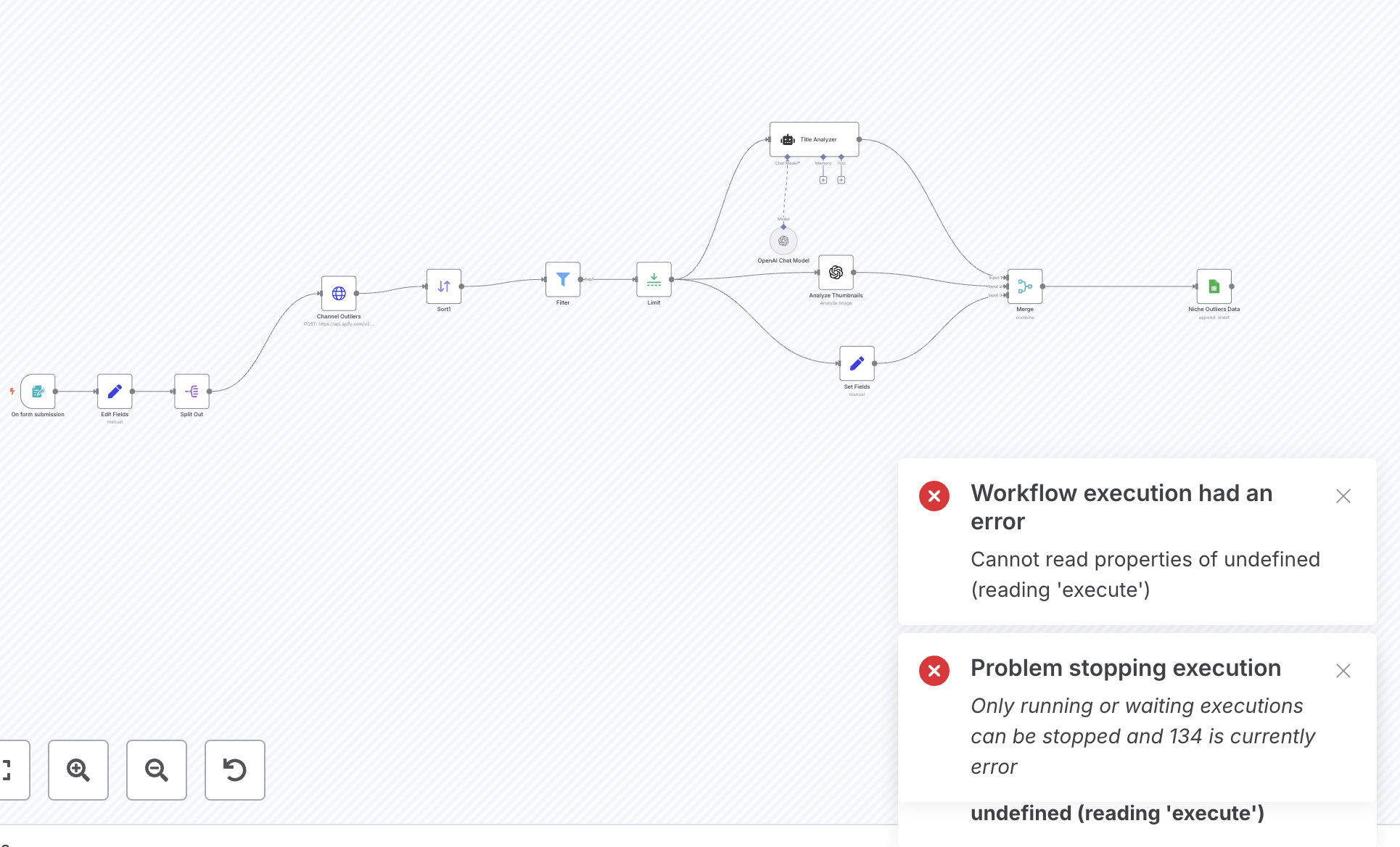

How do I debug this?
I have a workflow here and keep getting hit with this error whenever I insert the merge node to combine the inputs before hitting the Google sheets node where I want the AI responses to be in line with the edit fields.

Thank you for the response. This error starts as soon as I execute the workflow. The form doesn’t even pop up.
When you click “Execute workflow” in n8n, the system doesn’t just run the nodes connected to the trigger, it loads and validates the entire node graph, including all connections, even those that aren’t visibly active. If a node (like a Merge) contains an internal reference to a deleted or corrupted node, n8n will still try to resolve it during the startup phase. If that reference is undefined, the engine can’t build the execution plan and throws an error immediately, even if the node is far down the line or shouldn’t run yet.

I deleted the node, re ran the workflow (sucessfully) and then added the merge node again and still facing the same issue
