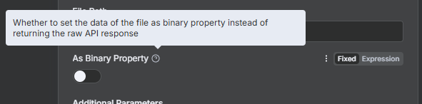

How am I supposed to download a binary file that I fetch with the “Get a file” feature of the GitHub node?
I see the file in my execution but it has a downlad button in it that I need to click manually, it seems. I put the binary data in the “data” field, but when I assign the data field to my email node as an attachment, nothing happens. In fact, the output of the GitHub node is the same as the code node that precedes it.
What am I missing?

If I understand you correctly, have you tried turning off the “As Binary Property” option?
I have (after sending my original post, I kept working on it). So I now see that I have the content in base64. So now I need to figure out how to send the attachment. I’ll do that tomorrow, cuz it’s too late now.…

Dang! It was much simpler than I thought. I’m so used to working with JSON that I was overcomplicating things.
The solution:
  • Set the “As Binary Property” to true
  • Give the property a name (data by default)
  • And put “data” in the attachment field of the email node
Easy peasy, and now it does what I want!
