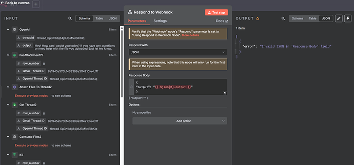

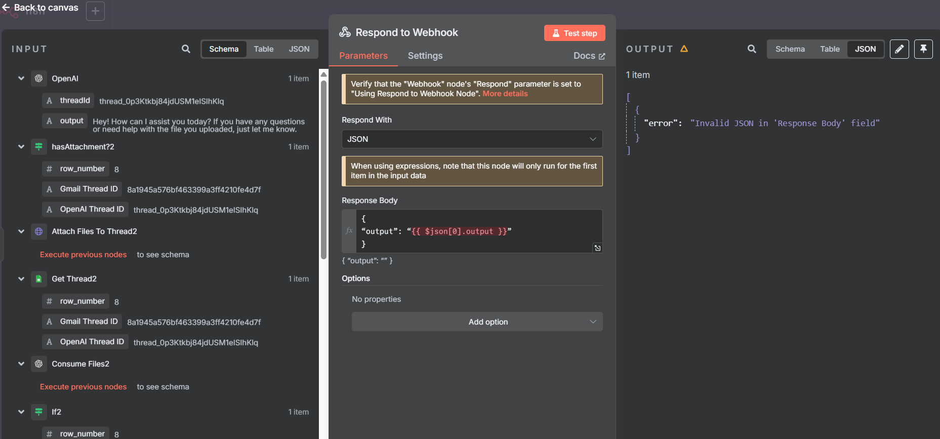

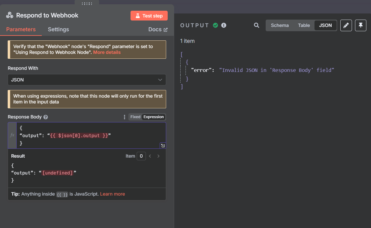

Oh I see, try this in the respond to webhook node.
“output”: “{{ $json[0].output }}”
Grot this is the result when I try this.

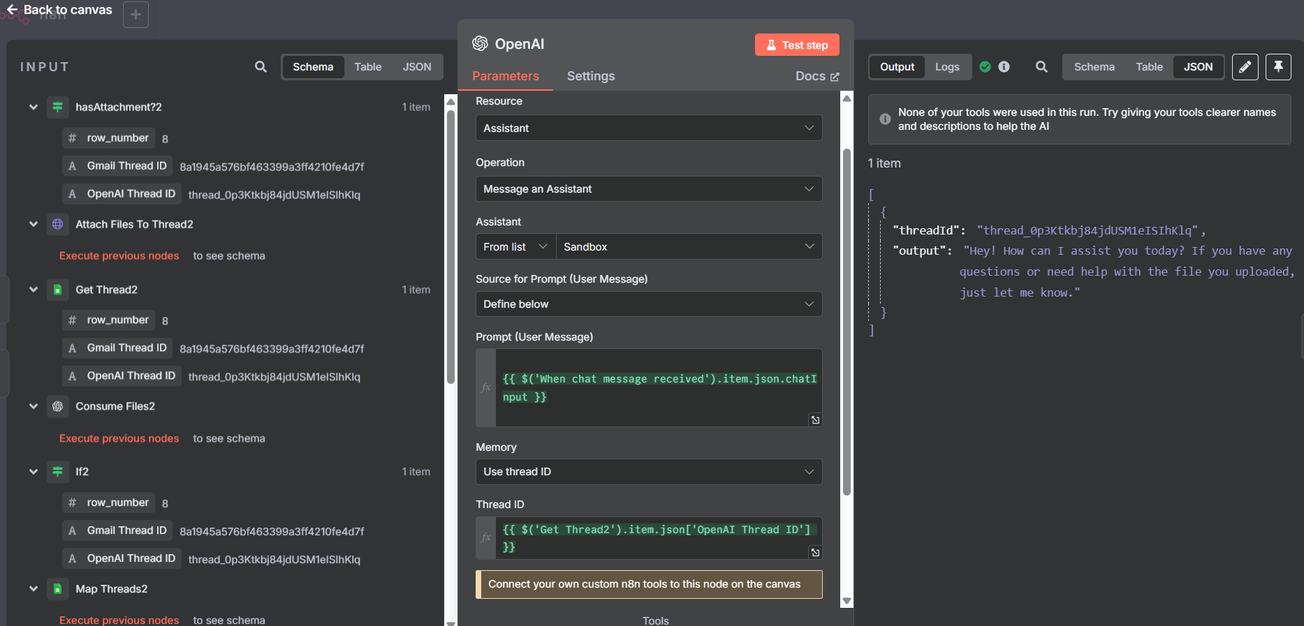

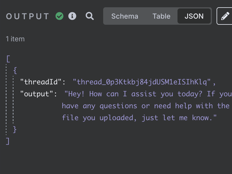

That’s strange. It should match your array output on the openai node. Could you share a screenshot of the output on the Openai node.
Yes here are screenshots from the openai node and respond to webhook node.

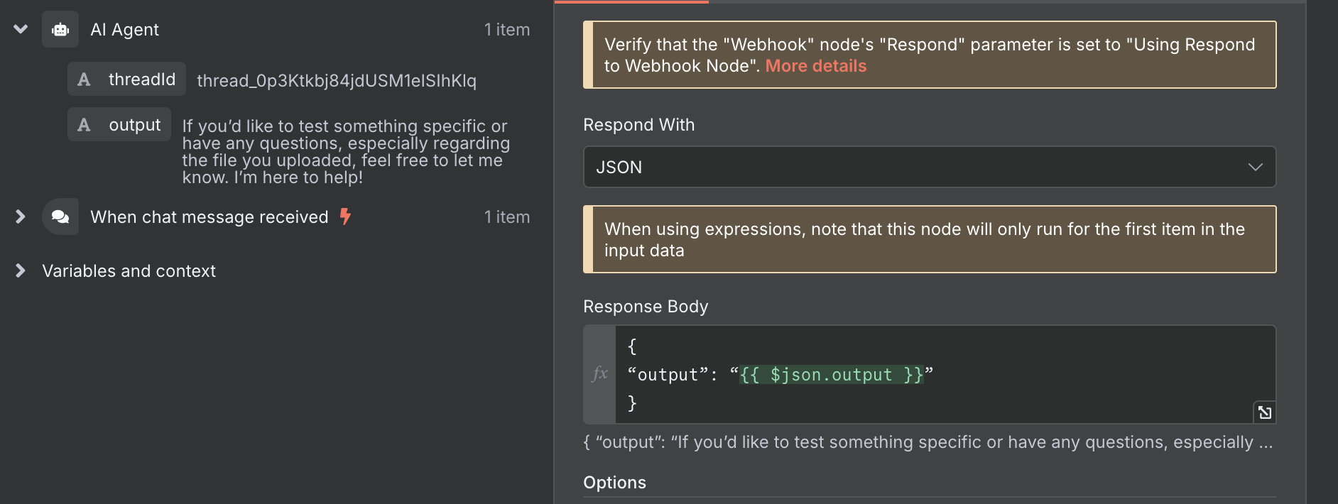

So looking at it further. You should have it like you did before.
“output”: “{{ $json.output }}”

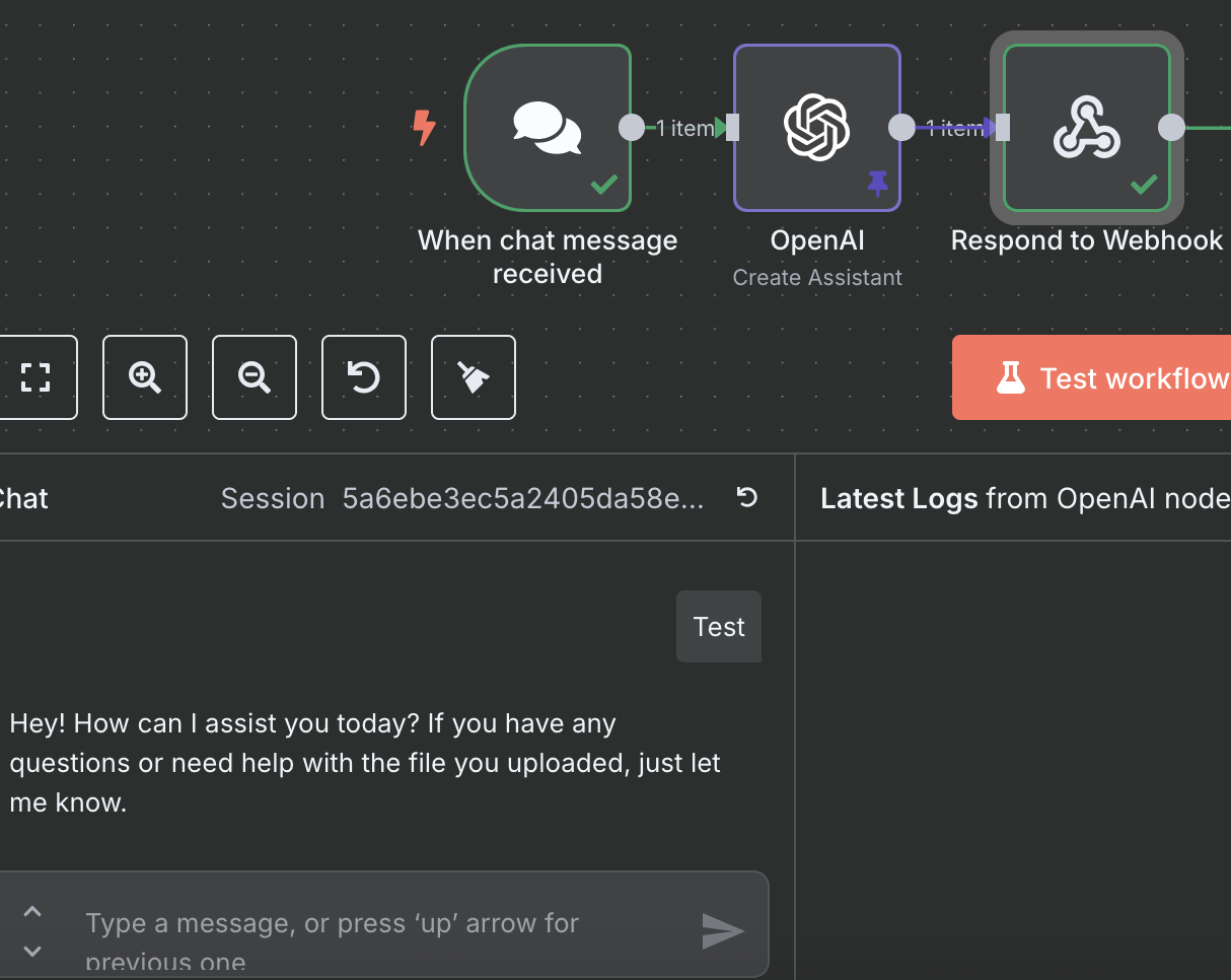

The output of the “respond to webhook” node isn’t what is being sent to the chat trigger. Could you test with chat trigger.
Very sorry for my delayed response. Life hit me for a bit.
When you said that the respond to webhook node isn’t what is being sent to the chat trigger that led me to explore a bit more. I didn’t pin point it precisely but it appears that the issue was related to my merge node. I suspect it was being recognized as the ending node and triggering the respond to chat node.
To fix this I set the node to wait for all inputs before proceeding this fixed my issue and allowed me to successfully get responses to my chat node.
