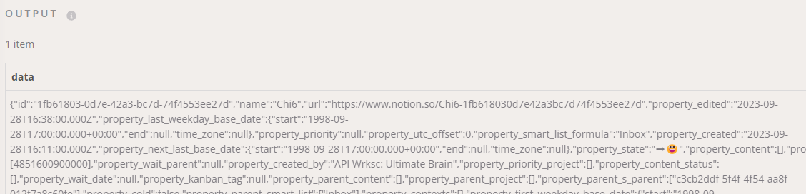

  • Output from Read Binary File: node:
  • Output from Binary to JSON node:
  • You can see above that the last output is in a different format. It’s like the entire JSON got stored inside a dictionary or object or something (still learning JSON structures).
What can I do to write and then read that Notion output JSON data in the exact same format as I first got it (as a table)?
Hi @protechtedd :wave: Deleted my other reply, I see what you mean now :sweat_smile:
Can you try a code node after your Binary to Json node, with this:
return JSON.parse( '[' + $input.first().json.data.replaceAll('}{', '},{') + ']' )
That should split out the JSON for you in the format you expect :+1:

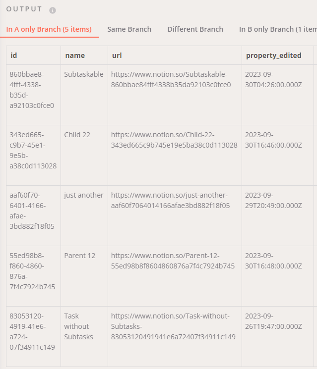

A quick recap of my goal: To write the output JSON from a Notion node into a valid JSON file, then be able to read that same file into a JSON/Table that n8n can compare via Comparison node with both Notion output and JSON file. Essentially, comparing a previous run to the current run to detect changes.

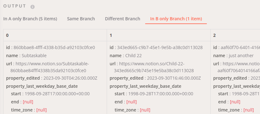

I updated the workflow from my original example. The “Write to JSON” row successfully converts and writes the Notion data to a JSON file. The “Read from JSON” row reads the saved file, but stores the output as a different format than expected, especially when compared to the original Notion format.
The strange thing to me is that when I copy the text from the Output > JSON tab from each, and paste them into a “text difference” tool, absolutely nothing is different between them. So this tells me that n8n is just parsing the data differently than I’m expecting for some reason; Do I need some node after “Binary to JSON” before sending to the Comparison node?
Workflow:
Screenshots below from the output of the final Comparison node.
Input A: Original Notion data
Input B: Read JSON file data
This was mainly thanks to @Jon so credit where credit is due - but can you try the following:
  • Change Binary to JSON to not set all data
  • Add JSON Parse Option
  • Add an Item Lists Node > Split out Items
That should fix this up for you!
