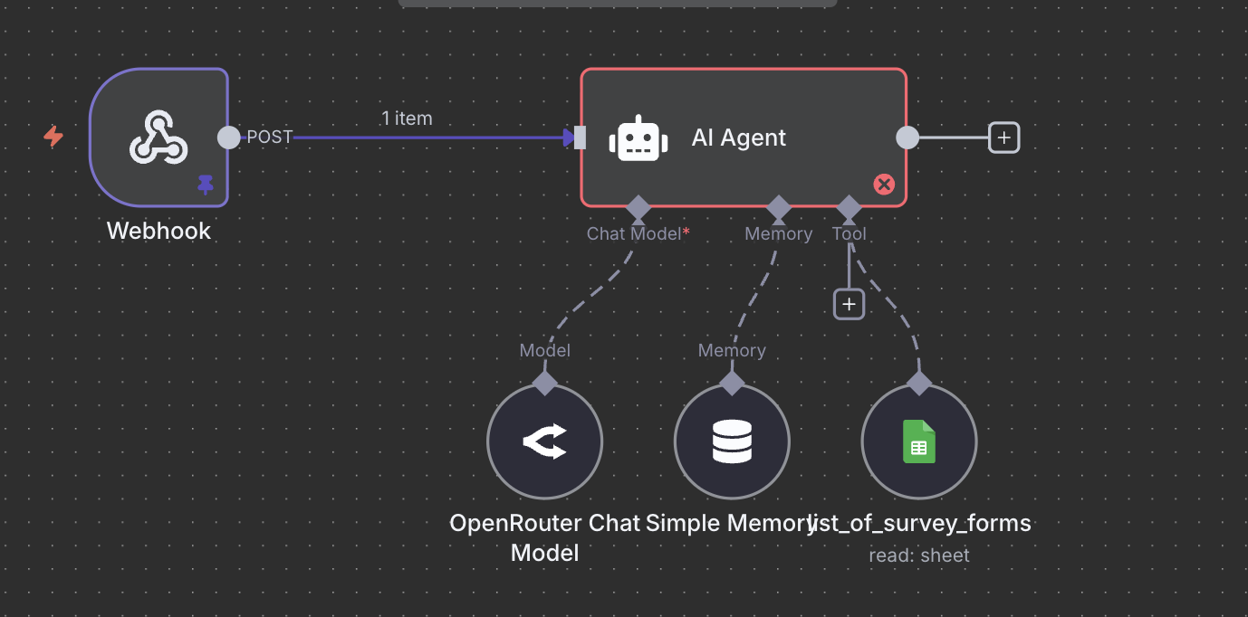

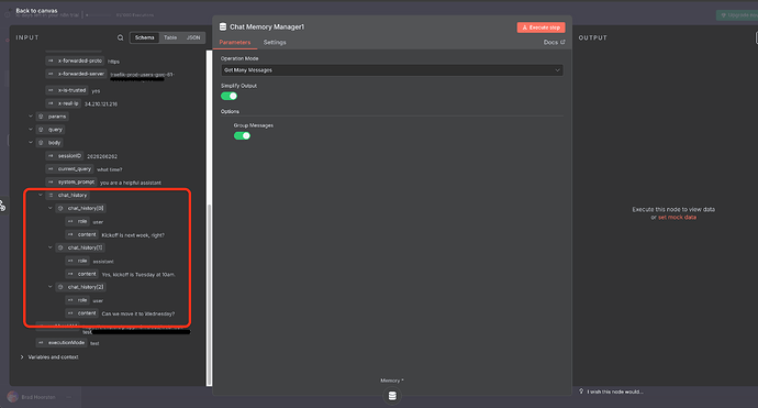

Thanks @solomon. I understand how to start new chats and continue them later. However, I have old chat conversations before starting with n8n - I previously went directly to OpenRouter and saved all chat history in my bubble database.
I want n8n to get up to speed on a previous conversation, in which n8n never had access to.
Here’s an example conversation history I have with an LLM, which is stored in my bubble databe. It’s the first time n8n is seeing this conversation.

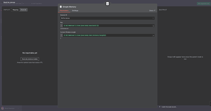

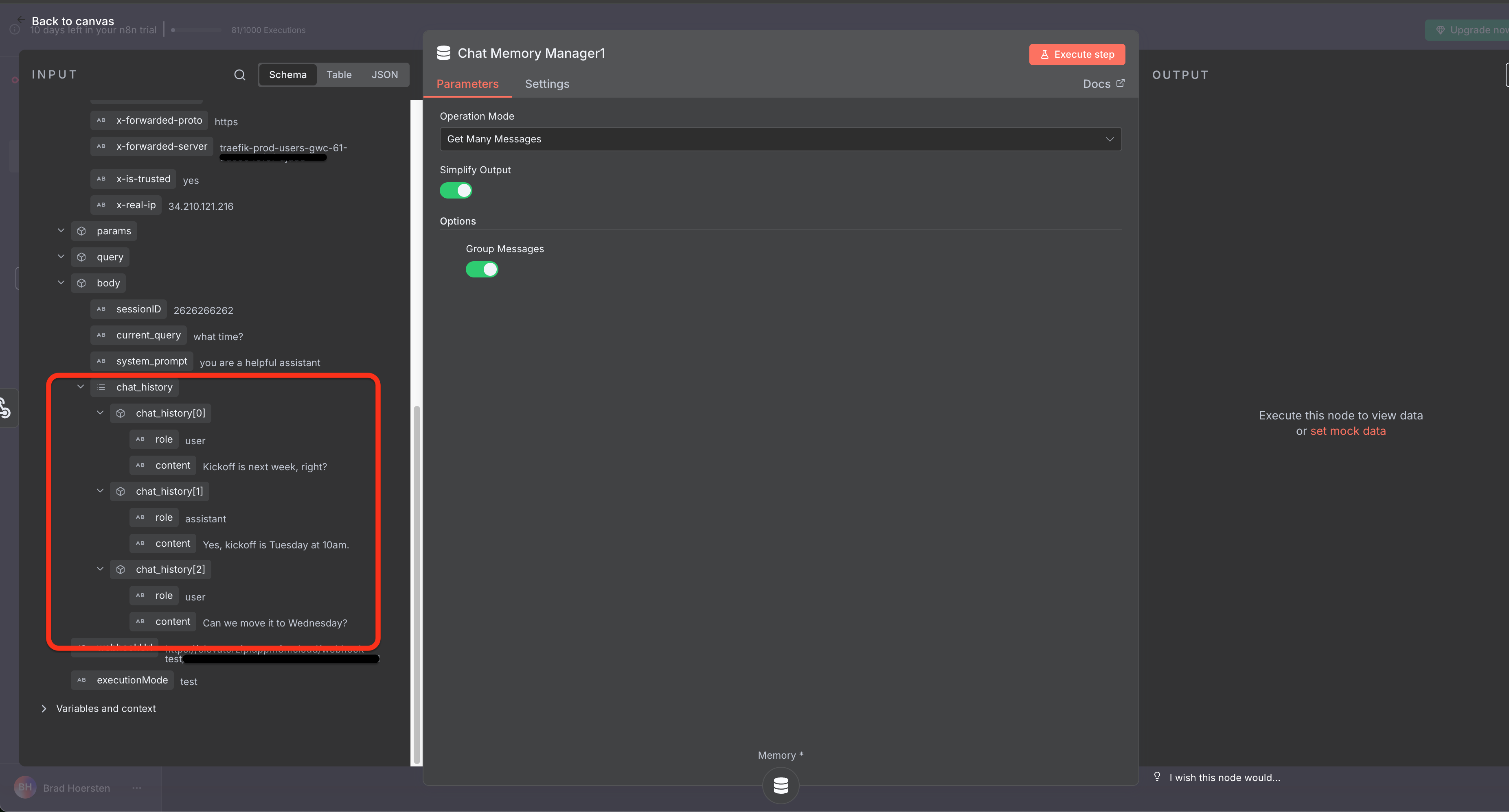

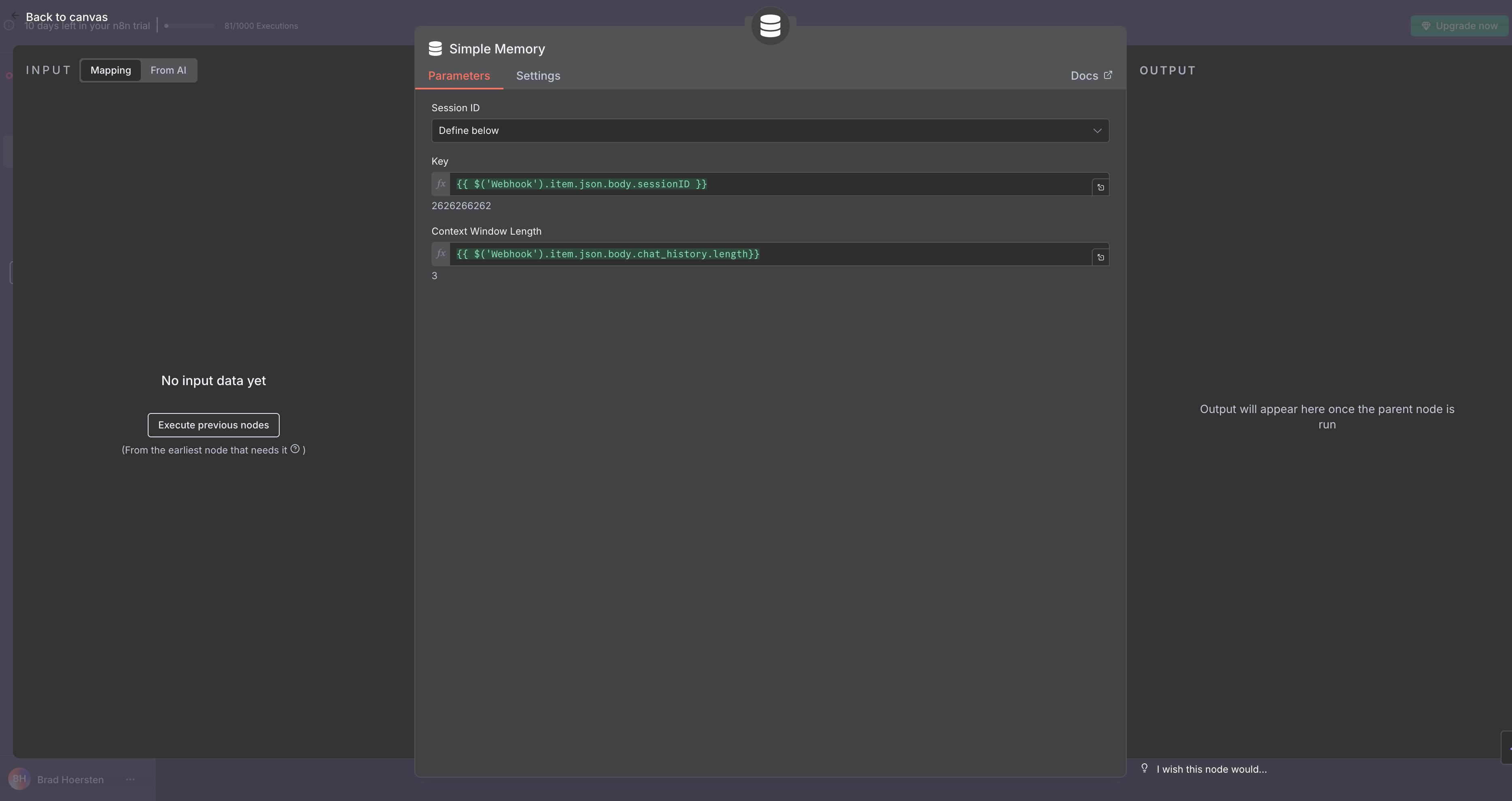

I’m able to successfully pass this info to n8n via webhook and use the chat history dynamically in later steps. I just can’t insert to memory. In short - I cant get my n8n agent up to speed with conversations that happened without n8n in the loop.

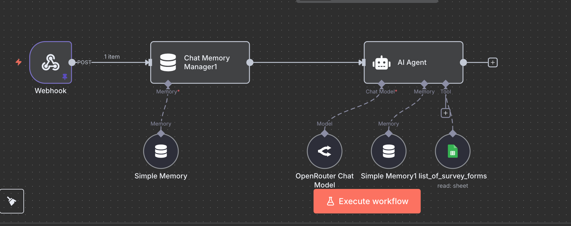

I thought the chatmemory manager node could help. And it feels like it will, but when I run it never takes my old messages - it never gets up to speed.
In summary: My problem is that I have old chat history stored in his Bubble database from before I started using n8n, and I want n8n’s memory to recognize and continue those old conversations. While I can pass the old messages into n8n via webhook, the Memory Manager node won’t load them (neither will simple memory off Agent), so n8n never “gets up to speed” on past chats. This makes it impossible to migrate my API with old conversations to n8n
I see. n8n doesn’t offer a database for you to edit like Bubble does. You need an external database.
I usually go with Supabase because it’s very easy to use. You can replace your Simple Memory node for any database.
The Simple Memory node uses n8n’s internal database. But there’s no clear way of editing that. And if you’re deploying your solution to the public, you’ll need an external database anyways.

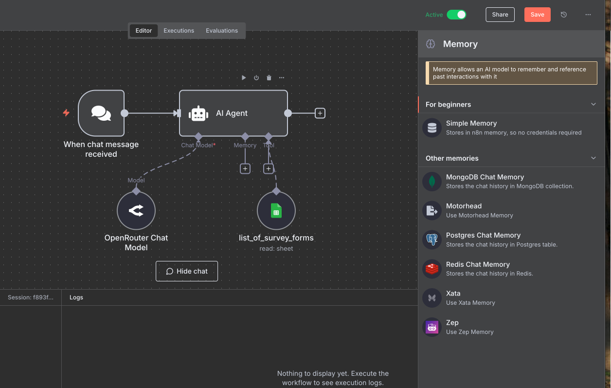

bubble is my external database, and I’m sending the chat history from the bubble databse. When I tap the memory [+] it does not give me an option for supabase or bubble.
you can see the only few options for memeory in this image.
Supabase uses Postgres under the hood. So you can connect to Supabase using the Postgres option.
If bubble allows external connections to the database, it’ll probably be one of those options too.
ooooh!!! this is sad. No bubble absolutely does not allow this. Quick quesitons:
is the simple memory context unlimited? Both in terms of number of chat messages, and time.
So I can return to a previous conversation with 1,000 chats (based on unique sessionID) and in 5 years? and it will pick up right where i left off?
simple memory does not persist it will be cleared when n8n instance restarts.
for longtime memory storage you can use persistent storage solution like PostgreSQL it will store as many number of chats as you want and it will be there if you have access to database.
