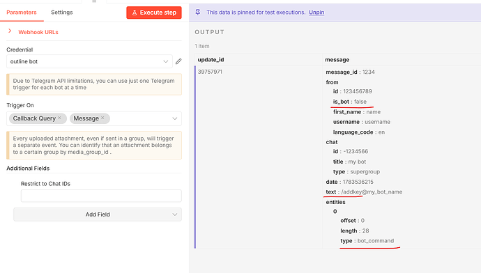

Telegram node treats all commands as messages, so you should parse them accordingly

The Telegram node does receive /new as a message text (Telegram sends all bot commands as messages with the text starting with /), so you don’t need to send the command from n8n - you just need to detect it and react to it. Add an IF node right after your Telegram trigger checking {{ $json.message.text === '/new' }}, then in the “true” branch reset your session. How you reset depends on what “session” means in your workflow - if you’re using an AI Agent with a memory node (Window Buffer Memory, etc.), change the Session ID to a new value for that chat (e.g., append a timestamp: {{ $json.message.chat.id }}_{{ Date.now() }}), which effectively starts a fresh context. Send a confirmation back to the user via a Telegram node, then continue your normal flow in the “false” branch.

After working on it more yesterday, I realized that the problem seems to be because I’m using a token for n8n to send a message to the Telegram bot. And because the n8n token is the same as the token of the Hermes bot, the bot does not reply because I think it believes it’s talking to itself. So any message that comes with the token of the bot is possibly ignored. When I send the message via n8n and I forward it manually in the same chat, then the agent reacts.
So now I’m looking for a solution where n8n can talk to the bot and not have the bot think that it’s talking to itself.
