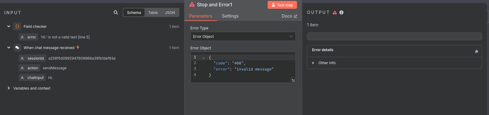

I don’t know how to make the node “Stop and Error” with the “Error Object” option work, the documentation says to set a JSON format, but the node doesn’t return anything, even if I catch it in a parent workflow.
No error message, the output of the “Stop and Error” node is just empty, even if i catch it in a parent workflow
Nothing as been outputed

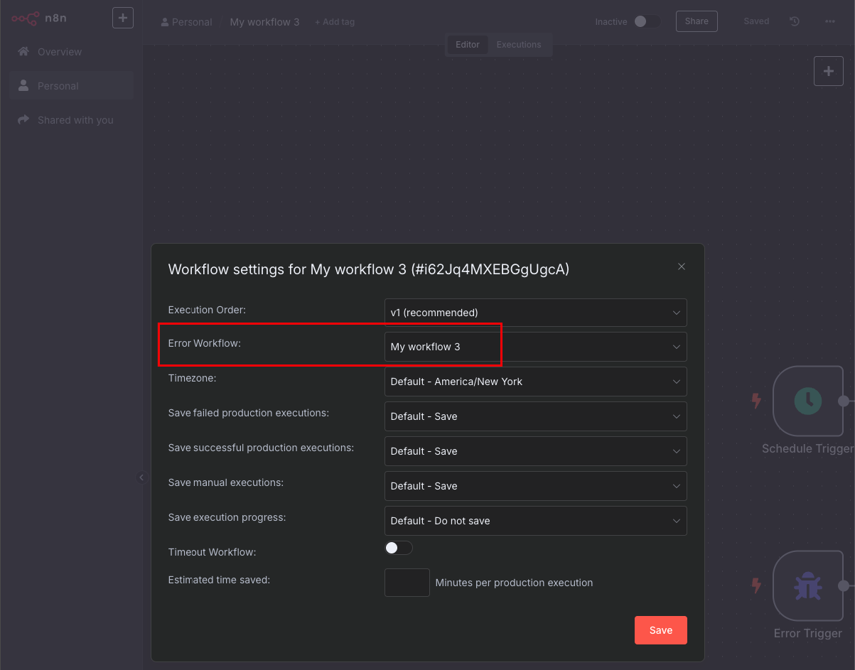

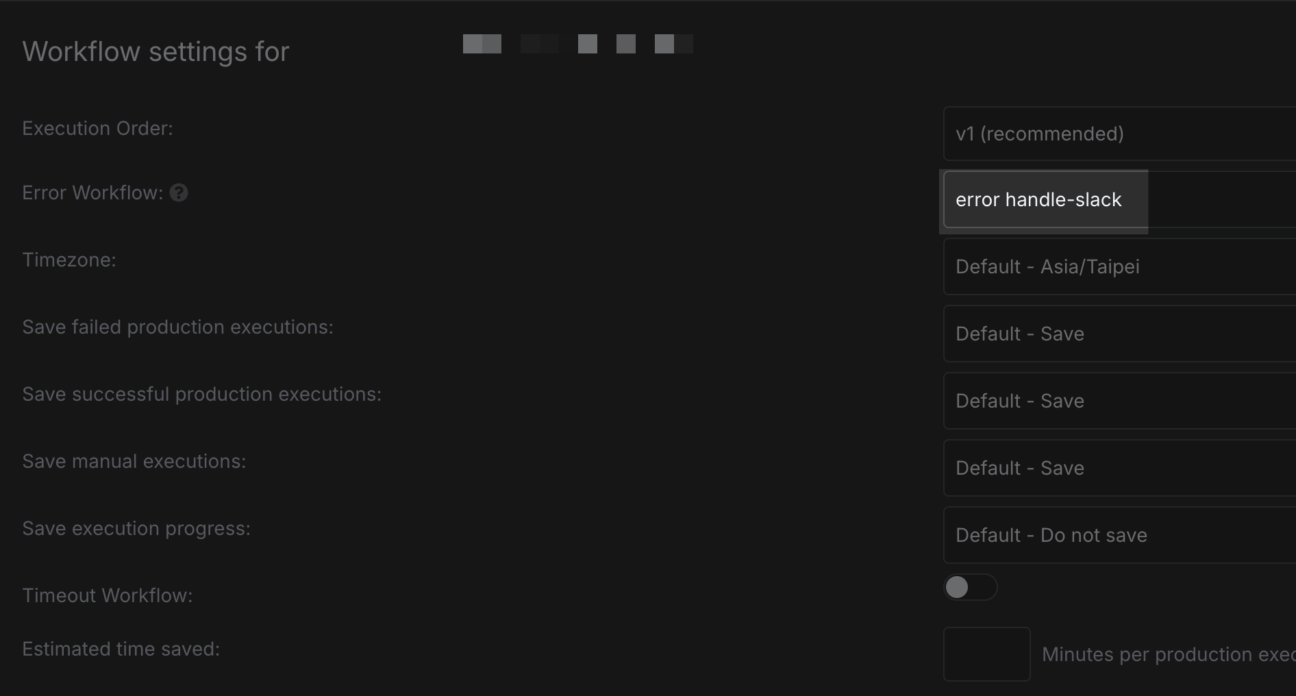

Second : Set up the Error workflow for this workflow
The error workflow will be triggered when this workflow throw an error
And only the execution is production. Manual trigger won’t execute the error workflow from my testing

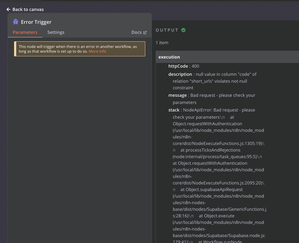

Essentially it’s like purposefully throwing an error in Javascript where you would normally use the throw statement. Now in the case of n8n, you need something to catch the error as this basically crashes the workflow on purpose with a custom error. To make this work, look at the example below. PS this only really works when the workflow triggers in production and NOT while clicking the test workflow button.
We need to set the properties of the workflow to tell it which workflow is responsible for catching the error. In this case I set it to the same workflow simulating a try/catch. This could be any other workflow, for exampe in my production setups, I have a single “error workflow” I use to ctach all errors from all workflows and then email myself the errors with execution data referenced.

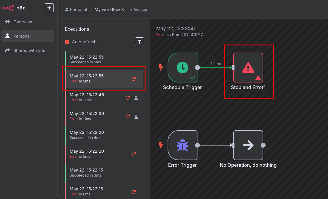

Once you enable this workflow and the scheduler trigger, you’ll see one execution with error and another where the Error trigger picked up the error details:

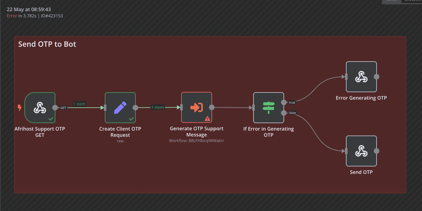

You should NOT call sub workflows using webhooks. Rather use the Execute Workflow node for this. This way if any node in your sub flow errors out, then the parent / calling workflow will catch it.
Here’s an example of one of our production flows. The sub flow had an error in one of the code nodes, but the parent caught it
And here is the result from the error workflow which then emailed us:

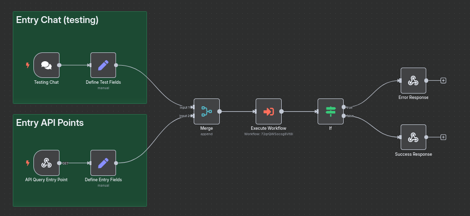

I didn’t explain myself clearly in my previous message, but we actually do have the same setup as the example you shared. Here’s a screenshot of our workflow with the Webhook trigger:

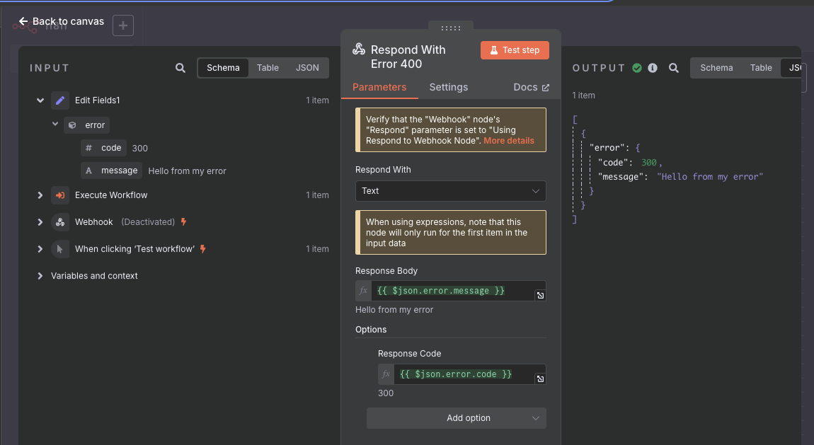

What I’m trying to achieve is the ability to catch the error object inside the If node, so I can pass it to the “Error Response” node and return it as the Webhook response.
If I use a global Error Workflow, I won’t be able to send the error back as part of the response to the original Webhook call.

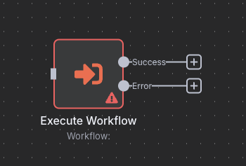

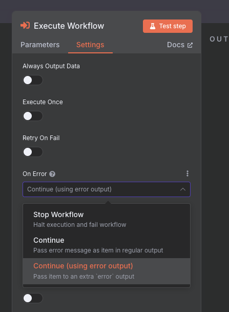

Oh the easiest way to do this, and similarly on any node, is to set the on error setting to continue using output:
This will create a new leg for which you dont need an IF node anymore
Here is an example:

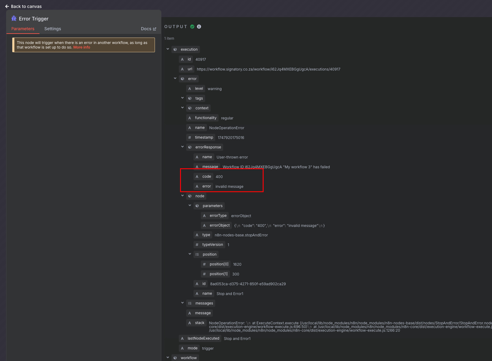

This workflow calls itself while forcing the error. I can only get this to work by setting the throw to a message and not an object.
Yes, that’s the point i tried to describe originally, I can’t get this to work by setting the throw to an “Error Object” :pensive:
It only works when I set it to an “Error Message”
Why do you need to set an object anyway in the error response? You want to bubble your errors up to the main calling parent workflow and then from there decide how to handle the errors via REST responses. So if setting an error code was the only reason, then just do it in the parent:

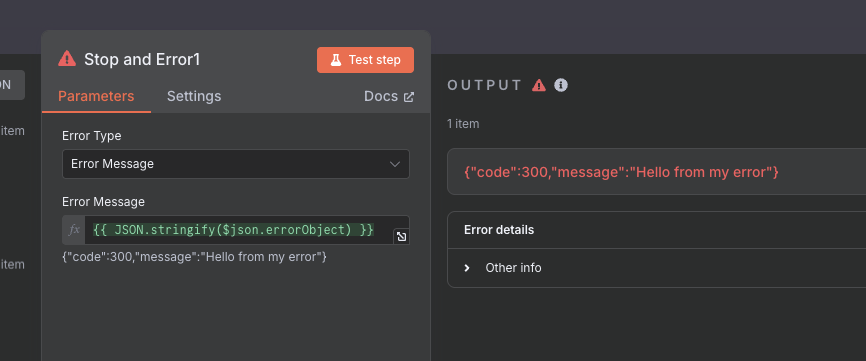

Then simply JSON.stringify your error object and parse it in the main service like this
It seems like the “catching” of the error will always return a string value even if an object was thrown.
