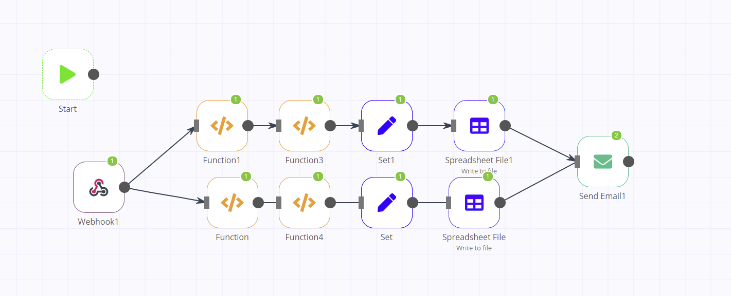

Hey @zied_hamzaoui,
You will have to use the Merge node and connect the two separate Spreadsheet files node to it.
Which setting should be used on the merge node, @harshil1712?
Hey @zied_hamzaoui,
Did you get it working? I am sharing a sample workflow that might help:
Note, that the value in the Binary Property field should be different in both the Spreadsheet File node.
