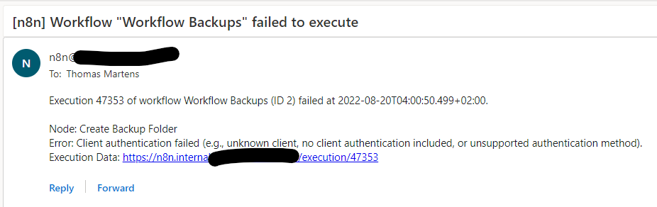

Hi @franchogarcia, you might want to simplify things a bit and create a single error flow for all your workflows (seeing the error handling seems to be the same). For a full introduction into the topic check out our blog post at Creating error workflows in n8n – n8n Blog
If you use console.log in a production execution, this would go into the server log and thus would not be visible in the browser console. So you might want to consider sending yourself an email with the error details in your error flow instead. It’s what I usually do, along with a link to the failed execution in case I want to investigate the error in more detail:
