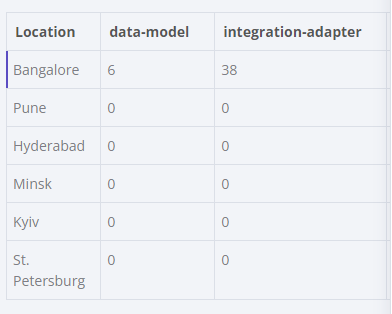

I am working on the n8n data set with code function Currently, I am having the data from the set function as below ::

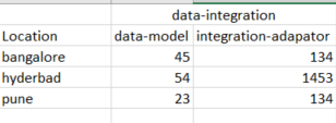

I am trying to add it as like below ::

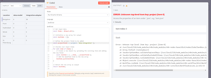

Can you please anyone help me on this code snippet. I am stuck in between. need to add the project name on above the Location

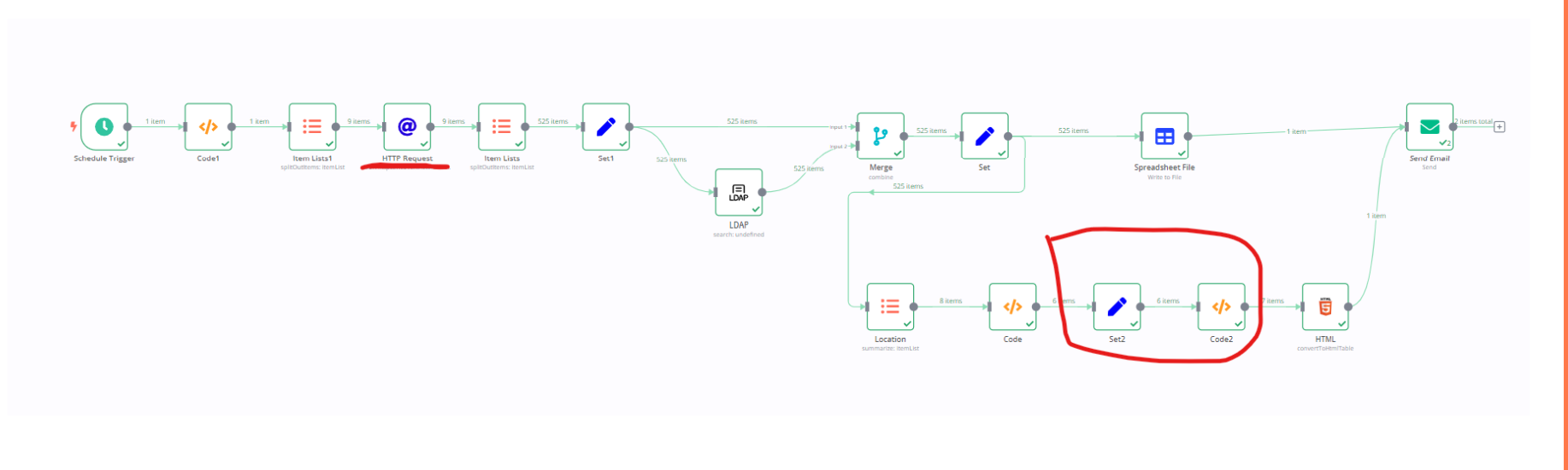

Below is the work flow, Where I am stuck do as I mentioned. below is the screenshot related to it
I am getting the values as below from the set function ::
For this , I am trying to add the one more row starting the table to define the project name as below ::
Please help me with this
You can convert it to CSV manually, but n8n is unable to convert it as XLS as you have non-standard header
