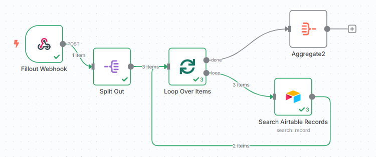

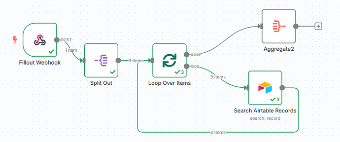

I’m working on a workflow in n8n and I’m facing an issue I can’t quite solve.
I have a form that returns a variable containing an array of 3 IDs (e.g. [id1, id2, id3]).
For each ID, I perform a search in Airtable to retrieve the name associated with that ID.
My goal is the following:
:right_arrow: Once I’ve retrieved the 3 names, I want to concatenate them into a single variable, either as an array or a string, and output a single item containing all 3 names together.
Right now, each Airtable search returns a separate item.
I’m looking for a way to gather all results into one single item that contains all the names.
Do you have a recommended approach or best practice to achieve this in n8n?
Thanks in advance for your help!

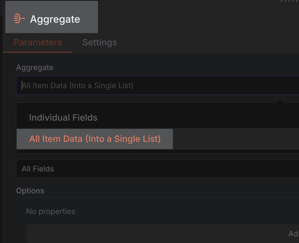

Aggregate should work
This option might meet your requirement.

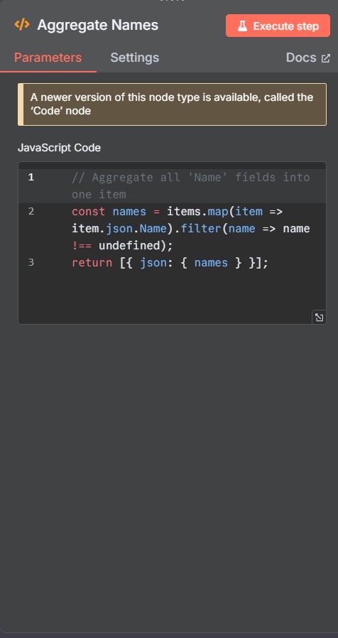

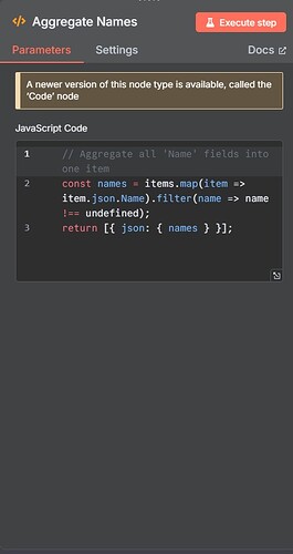

Hey, Arthur! As an option - you can aggregate names with a Code node

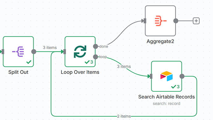

yep i tried but my workflow didn’t go through de “done” output (dont know why)

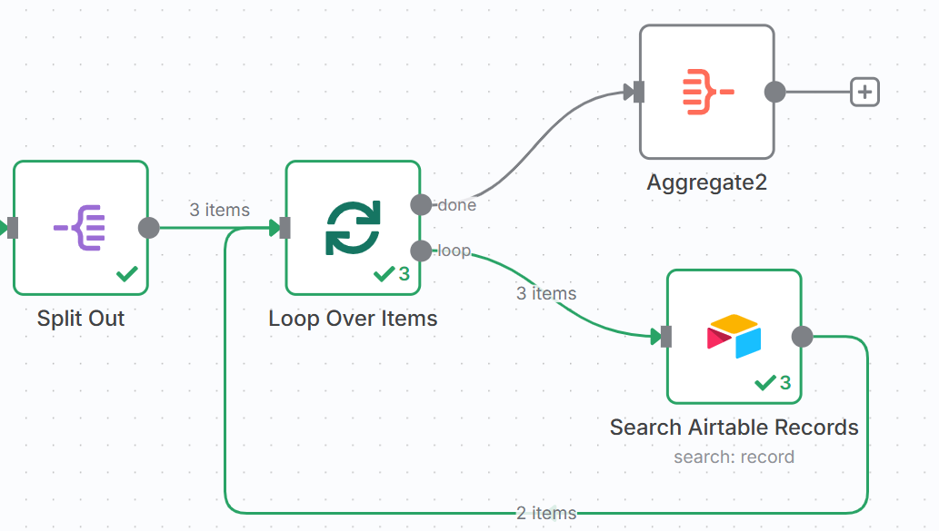

Looks like the problem is not from Aggregate since it didn’t being triggered at all.
Can you confirm 3 searchs all have a result?
Or can you check out the option always output data in the Airtable node
oh yeah i missed it, now it works and the aggregate works too, thank a lot !
