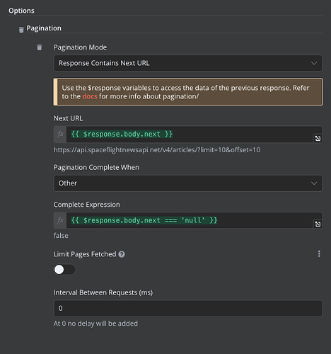

Is there any reason why you’re doing the pagination as an additional loop outside of the HTTP request node?
Does the pagination option of the node not work for you? Because if you were doing the pagination within the HTTP node itself it would gather all the results into one output.
Something like this (e.g. when response includes a NextURL:

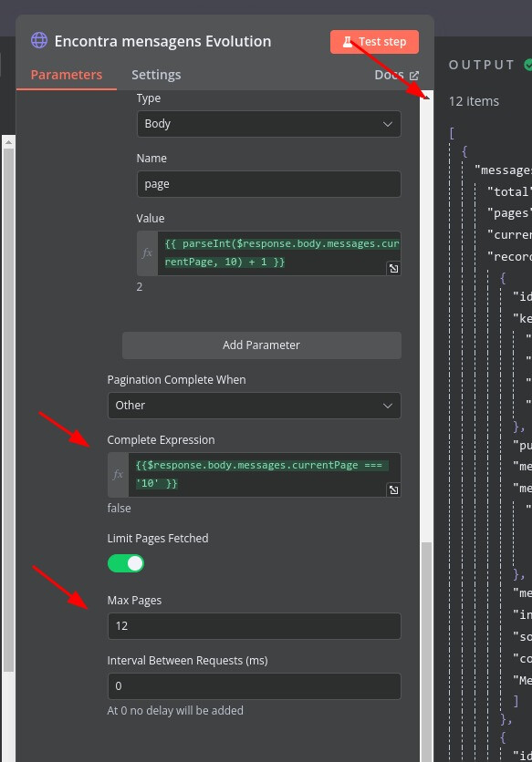

However, I’m struggling to get the paginationCompleteWhen condition to work properly. Here’s what I’m trying to do:
  new Date($('Define dados').item.json.data_limite_evolution).getTime()
  ($response.body.messages.records.last().messageTimestamp * 1000)
  • The first variable is the minimum timestamp to ensure that I don’t fetch data older than this value. Converting an ISO date to Unix time works correctly here.
  • The second part is where I’m stuck. I need to compare it against the last message’s timestamp, but no matter how I format it, the condition never works.
  • In the preview, the value appears correctly, but at runtime, I get the error:
    “Cause detailed Missing sourceData (probably an internal error).”
This is my full HTTP Request node configuration:

very strange… the complete expression doesnt work.
Thanks, @ria !
I’ve made it work with this expression:
{{ DateTime.fromISO($json.data_limite_evolution).toISO() >= DateTime.fromSeconds($response.body.messages.records.last().messageTimestamp).toISO() }}
I don’t know why it didn’t work the other way, since it looked fine in the preview.
Maybe it’s a bug.
