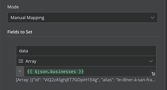

I am batching requests to an API which returns a field containing array. I’m using split-out to parse out array and append to an existing variable. However, I am getting an odd result that seems to create an array of arrays. I was able to find a workaround with the Code node, but the behavior from split-out to set node seems odd. Ideally I want to avoid using Code node as I read that it is a memory intensive node.

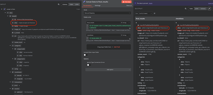

Yes, so I tried using the Set node alone. But I could not figure out why it wasn’t appending to the existing array. Here is the updated workflow to demonstrate.
Because with each loop you run a different iteration independent of the previous one. If you want to refer to a previous iteration you need to engage $runIndex variable. See Output of other nodes | n8n Docs.
i don’t understand. If this is my set expression:
{{ $('Create vars').item.json.final_results.append($json.data) }}
then this means, by the 2nd iteration, final_results should already contain the previous $json.data. This should just append the new $json.data to it shouldn’t it?
I don’t understand where $runIndex would be applicable here since that doc shows it applies to all, first and last methods, which i’m not using.
Hey @jtoh , I think I misunderstood. The problem with your append is you are appending arrays to the array in “Create vars”. I believe you want to append items (not array of items) to the array. For that, you need to replace append with concat as below:
{{ $('Create vars').item.json.final_results.concat($json.data) }}
See JavaScript Array concat() Method for details on the function.
Yup, its funny I actually realized that too. But unfortunately, the behavior is still the same. I pinned the data for you to see. It must be something up with that set node because i’m seeing the correct data from the input window.
