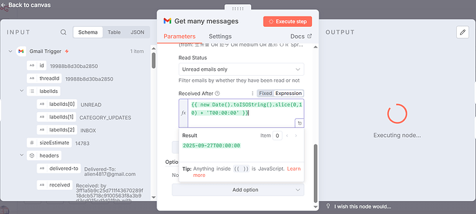

Hi everyone,
I’m running into an issue where my workflow keeps going into an infinite execution loop.
Here’s my setup:
  • Trigger: Gmail Trigger (Unread emails only)
  • Next step: Gmail → Get Many Messages
  • In the Received After field, I’m using this expression:
    {{ new Date().toISOString().slice(0,10) + 'T00:00:00' }}
  • The result is always something like 2025-09-27T00:00:00.
The problem is that every time the workflow executes, this expression recalculates to today’s midnight. As a result, Gmail keeps returning the same set of emails, which triggers the workflow again → causing an endless loop.
My question:
What’s the best practice in n8n to avoid this loop? Should I:
  • Rely only on Gmail Trigger and remove the “Get Many Messages” node?
  • Use $now or $prevNode to calculate a relative time range instead of resetting to midnight every run?
  • Or is there a way to de-duplicate emails (by ID or threadId) so they don’t keep re-triggering the workflow?
I’d appreciate any suggestions or examples of how you’ve handled this problem. Thanks!
hello @alien4817
Use a Remove Duplicates node with the “Remove Items processed in previous executions“ option after your gmail trigger node
thanks for your kindness, it’s work!!
