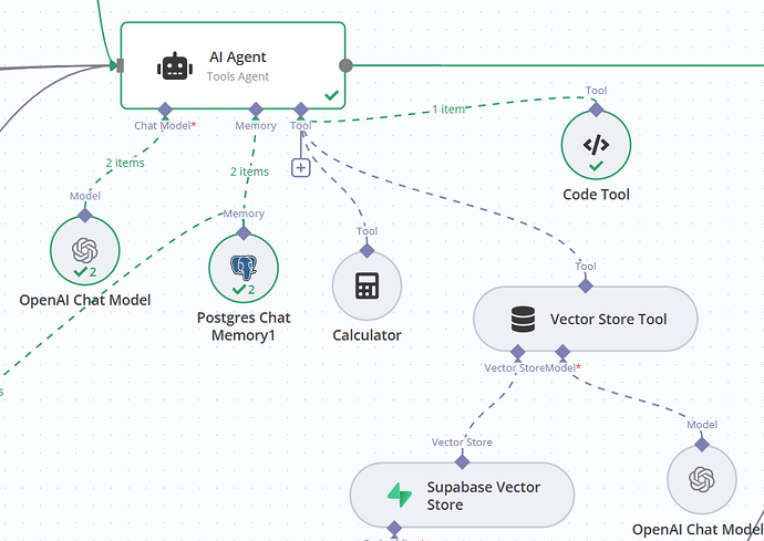

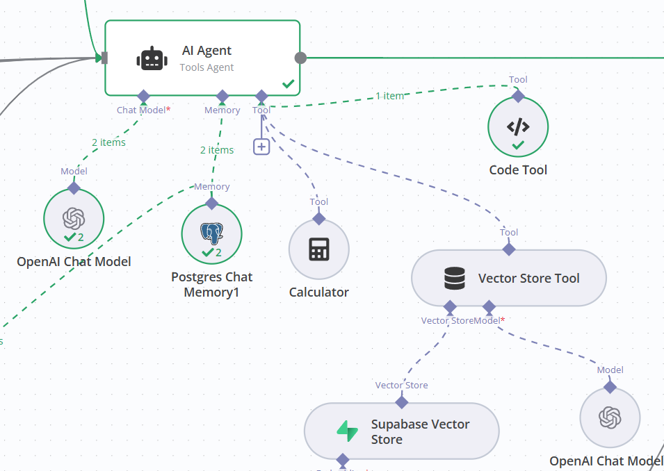

I have implemented a system where a query is first searched in vector storage. If no response is found there, a predefined phrase from the “code tool” is used. However, I’ve encountered an issue: the prepared phrase from the “code tool” is being further processed by the “ChatModel OpenAI,” which alters its content.
How can I ensure that the prepared response from the “code tool” is sent directly to the user without being processed or modified by the “ChatModel OpenAI”?

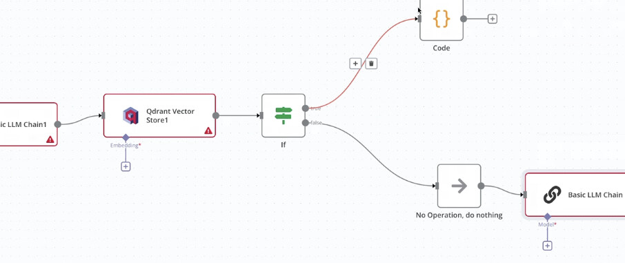

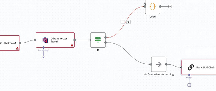

You could also try to implement a different architecture all together, where you basically use a simple LLM chain instead to receive the user input and then follow up with a simple vector store call followed by an if node (or similar) to determine if the vector store search result is sufficient and use another LLM chain if so to respond to the user or use the fallback code node.
So something like this:
(sorry for the bad quality, was in a rush)
