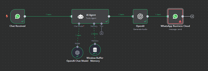

After getting the audio file from chatgpt when I try to make my bot send the audio file whatsapp tells me that the file type must be other, but I don’t know how to change it

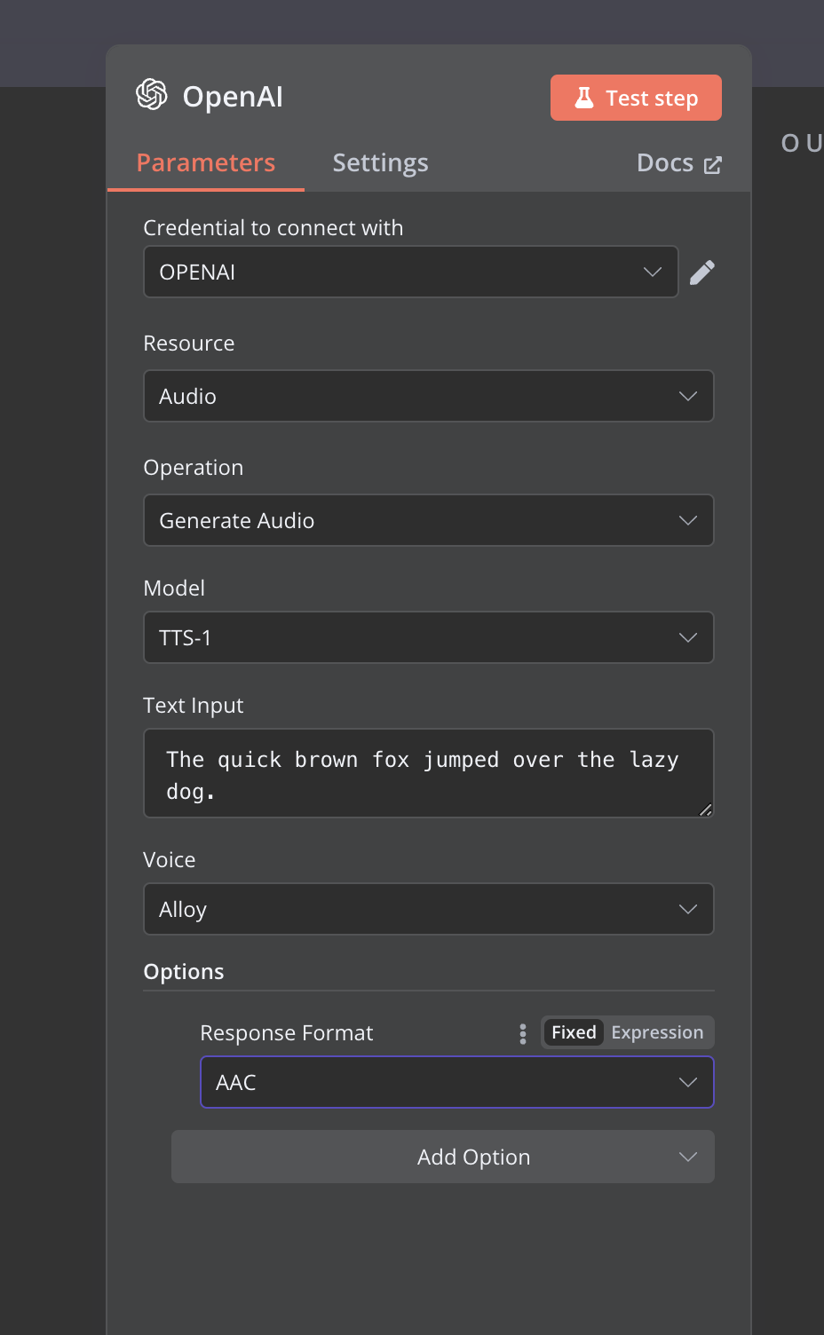

Try maybe changing the response format in the options to “aac”. That seems to be supported according to your error message.
thanks, i solved it
