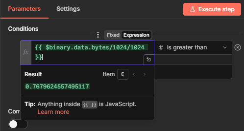

Hi @Ruriko,
As friends have mentioned, I’d like to add the most straightforward method for future reference and indexing,
Since the binary object now already has a property called bytes, you just need to convert it to the unit you want,
For example, to convert it to MB, you can use this expression:
{{ $binary.data.bytes/1024/1024 }}
