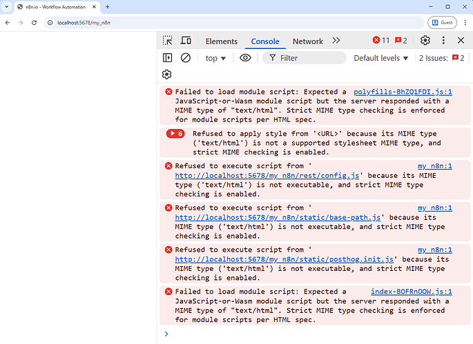

I’ve tried setting the environment variables like this and then running pnpm start again to start the project:
then,show the info :Editor is now accessible via: http://localhost:5678/my_n8n
But when I open this address, the page is blank and the console reports an error:
It seems that the static files path cannot be loaded

I think this is a scenario that many people will need to use. Has anyone successfully done this configuration?
