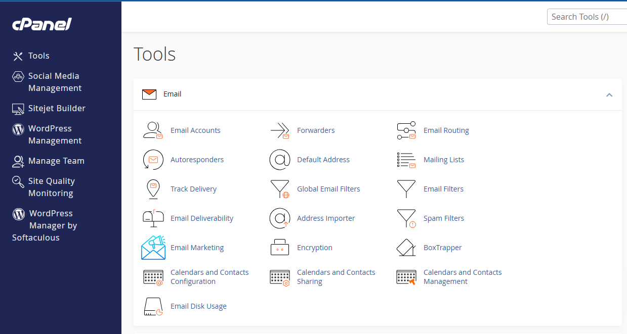

  1. Log in to your cPanel dashboard.
  2. Click Email Accounts.
  3. Create a new email (e.g., you@domain.com) and set a strong password.
  4. Save the password somewhere safe.

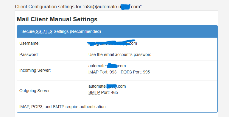

  5. Open the inbox. You’ll find a welcome email with configuration details—you’ll need those for SMTP setup.

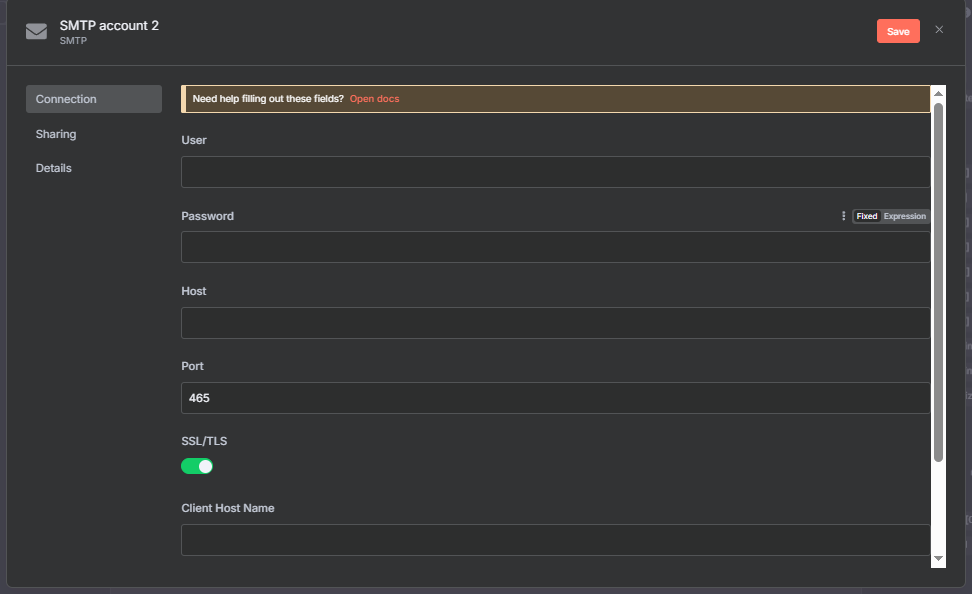

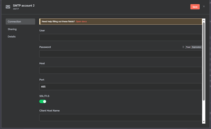

  1. Click “Create new credential” under the SMTP settings.
  2. Fill in the fields as follows:
    • User: Your full email address (e.g., you@domain.com)
    • Password: The password you created in cPanel
    • Host: The Outgoing Server URL from your email configuration (e.g., mail.domain.com or sub.domain.com)
    • Port: Typically 465 (make sure it’s the outgoing SMTP port, not the incoming one)
    • SSL/TLS: Leave this enabled
    • Client Hostname: Use the same value as the host (e.g., mail.domain.com)
  3. Click Save.

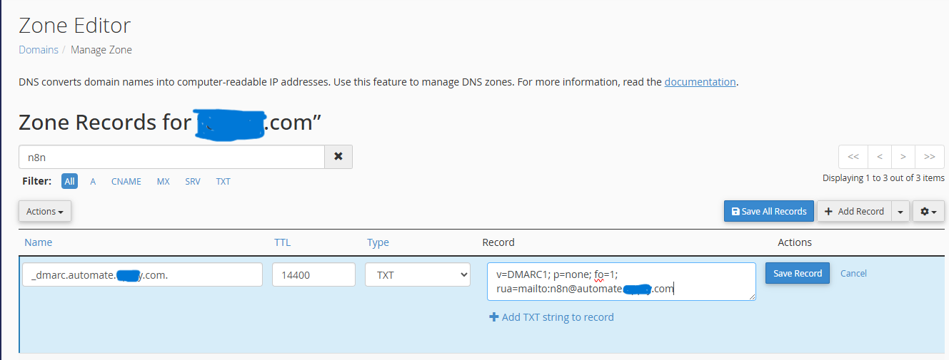

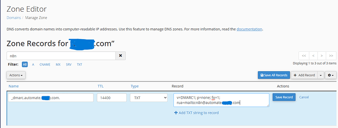

To Create a DMARC Record in cPanel:

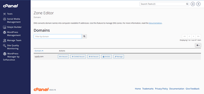

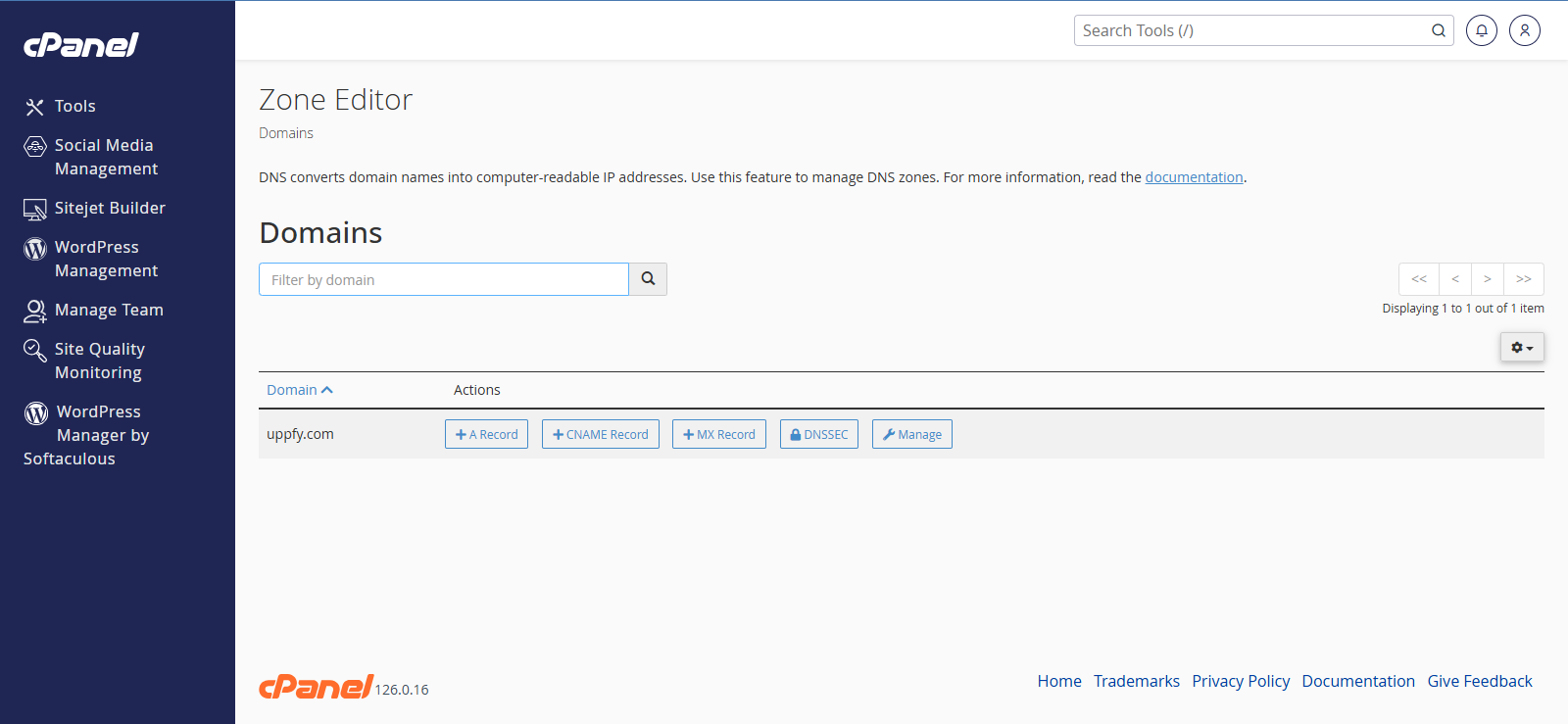

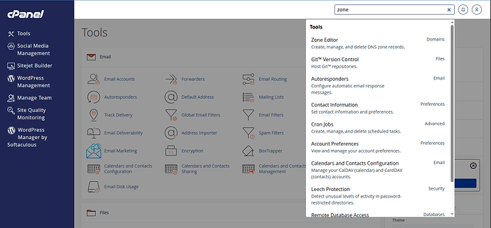

  1. Go to cPanel > Zone Editor.
  2. Find your main domain (apex domain like domain.com) and click Manage.
  3. Click “Add Record”, then configure:
    • Name: _dmarc. (or _dmarc.subdomain. if your email is on a subdomain). This field autocompletes to fill the domain, so don’t panic when it does.
    • TTL: Leave as default
    • Type: TXT
    • Record:
      v=DMARC1; p=none; fo=1; rua=mailto:you@domain.com
    Replace you@domain.com with the actual email you’re using.
  4. Click Save Record.
:warning: Don’t worry about any warnings like “A record can’t have an underscore”—they disappear after we select type.
