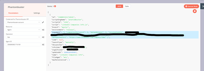

When using the Launch operation of the Phantombuster node, you could pass on arguments to Phantombuster by adding a new field to the n8n node:
If you’re not sure which arguments your Phantom uses, you can use the Get operation which will return a list of arguments:
The example Phantom “LinkedIn Companies Info” for example would require sessionCookie and spreadsheetUrl and would then complete as expected:

Hi @Ninotna, for the “LinkedIn Companies Info” phantom , have you tried setting both sessionCookie and spreadsheetUrl? Despite the name, spreadsheet URL can point to an individual company, for example https://www.linkedin.com/company/ibm/.
