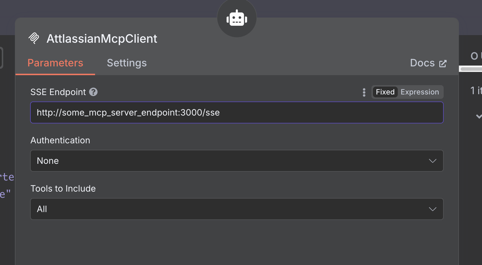

The n8n MCP client only supports the SSE method. You have to deploy a single server and run it in the following way to serve it, then set the server’s endpoint in the MCP client node to enable calls.
command: [“sh”, “-c”, “uvx mcp-atlassian --transport sse --port 3000 --confluence-url=https://your.wiki.com --confluence-personal-token=… --jira-url=https://your.jira.com --jira-personal-token=…”]

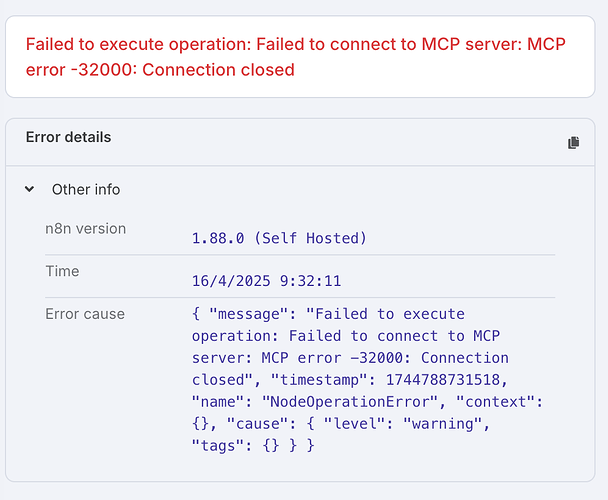

I am get this error when try to list the tools…
Am I missing something?
Same! Would love some help or guidance to solve!
  "errorMessage": "Failed to execute operation: Failed to connect to MCP server: MCP error -32000: Connection closed",
  "errorDetails": {},
  "n8nDetails": {
    "time": "5/1/2025, 9:30:51 AM",
    "n8nVersion": "1.89.2 (Self Hosted)",
    "binaryDataMode": "default",
    "cause": {
      "message": "Failed to execute operation: Failed to connect to MCP server: MCP error -32000: Connection closed",
      "timestamp": 1746106251183,
      "name": "NodeOperationError",
      "context": {},
      "cause": {
        "level": "warning",
        "tags": {}
