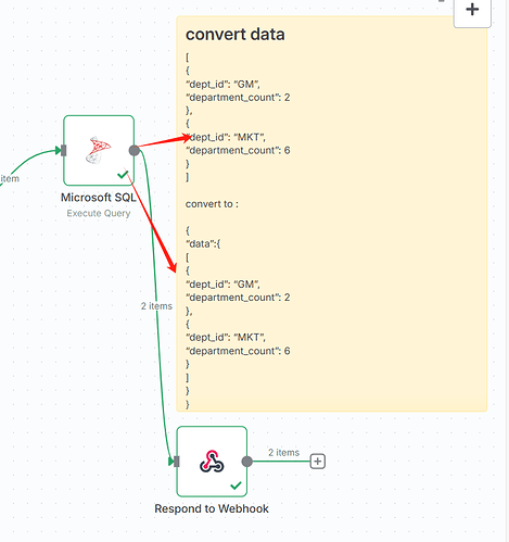

I used the sqlserver node to query multiple records, and the output is a JSON array, how to wrap this array into a JSON object and then output?
I found a lot of nodes but couldn’t achieve it!
Please help,thanks!
Please help,thanks!
Try the Aggregate node.
Also do you actually need the array wrapped in curly braces in the data property? It also would be an invalid JSON/object notation without assigning an array to a property of any kind inside the curly braces. Besides array per se is a valid JSON (and surprisingly also an object).
thanks ,i try the aggregate node achieve it!
