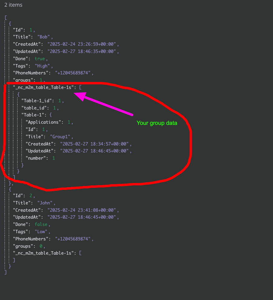

Suppose you create a new Application record.
You have to pass data about you group to the record.
Do get record and you will see it structure, look at the picture.

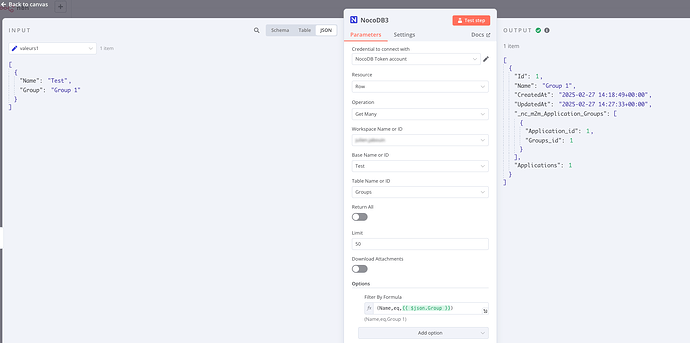

@Julien_J i think this will help you create what you are looking for in n8n,
  1. First, get the ID of “Group 2” using a NocoDB node:
  • Operation: “Get All Records”
  • Table: “Groups”
  • Additional Options: Add filter where Title equals “Group 2”

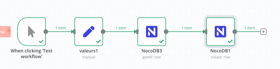

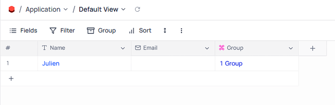

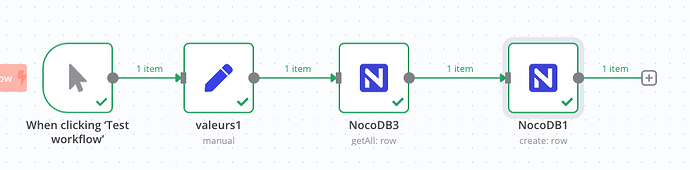

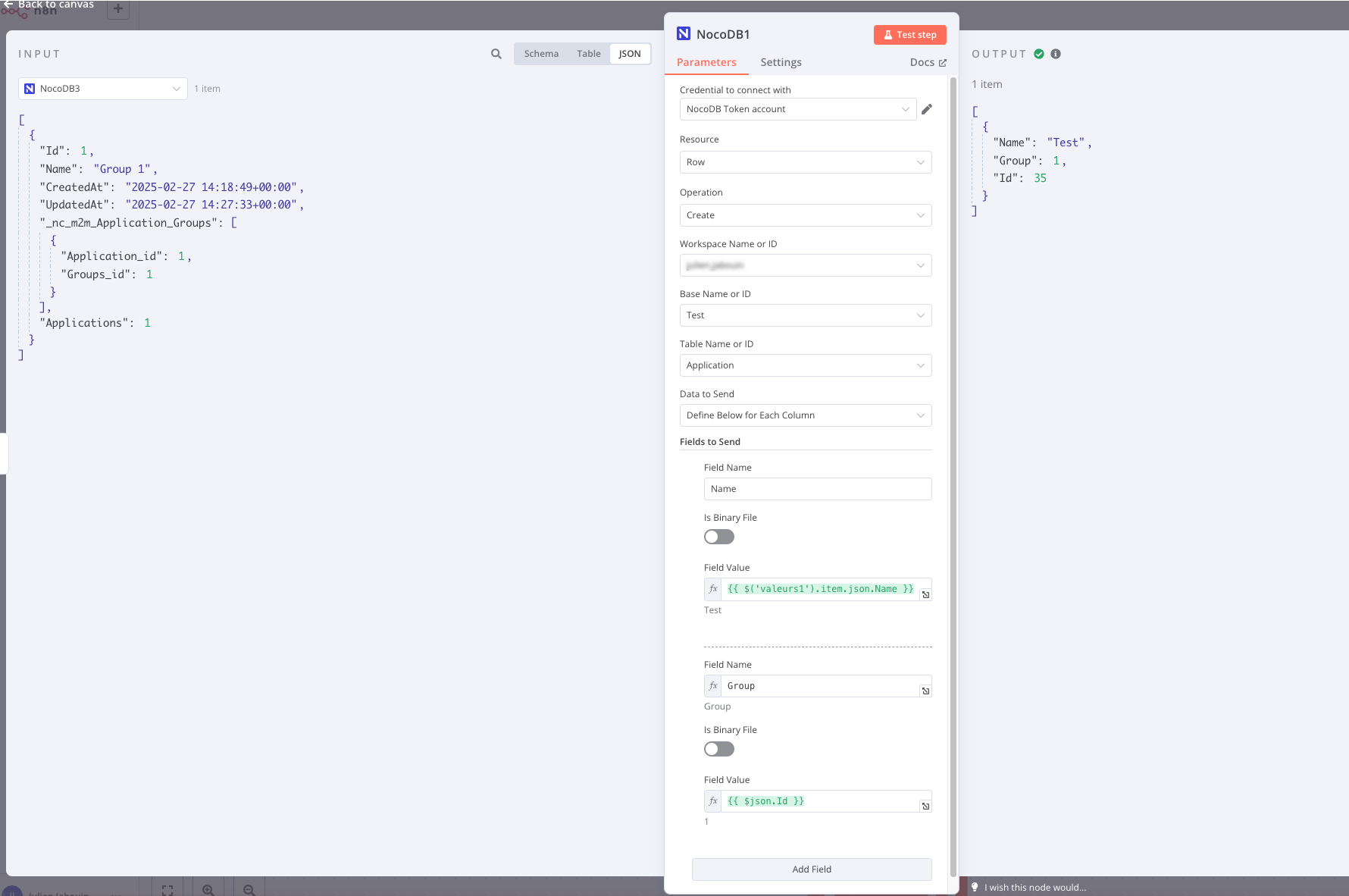

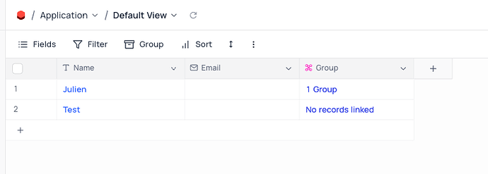

Thanks @Yo_its_prakash, but it doesn’t work for me.
This is what I have :
And in Nocodb :
“Test” has no group link.

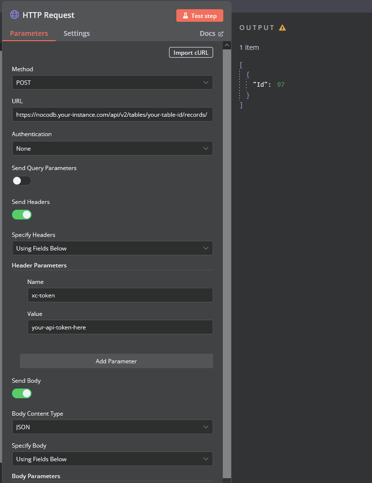

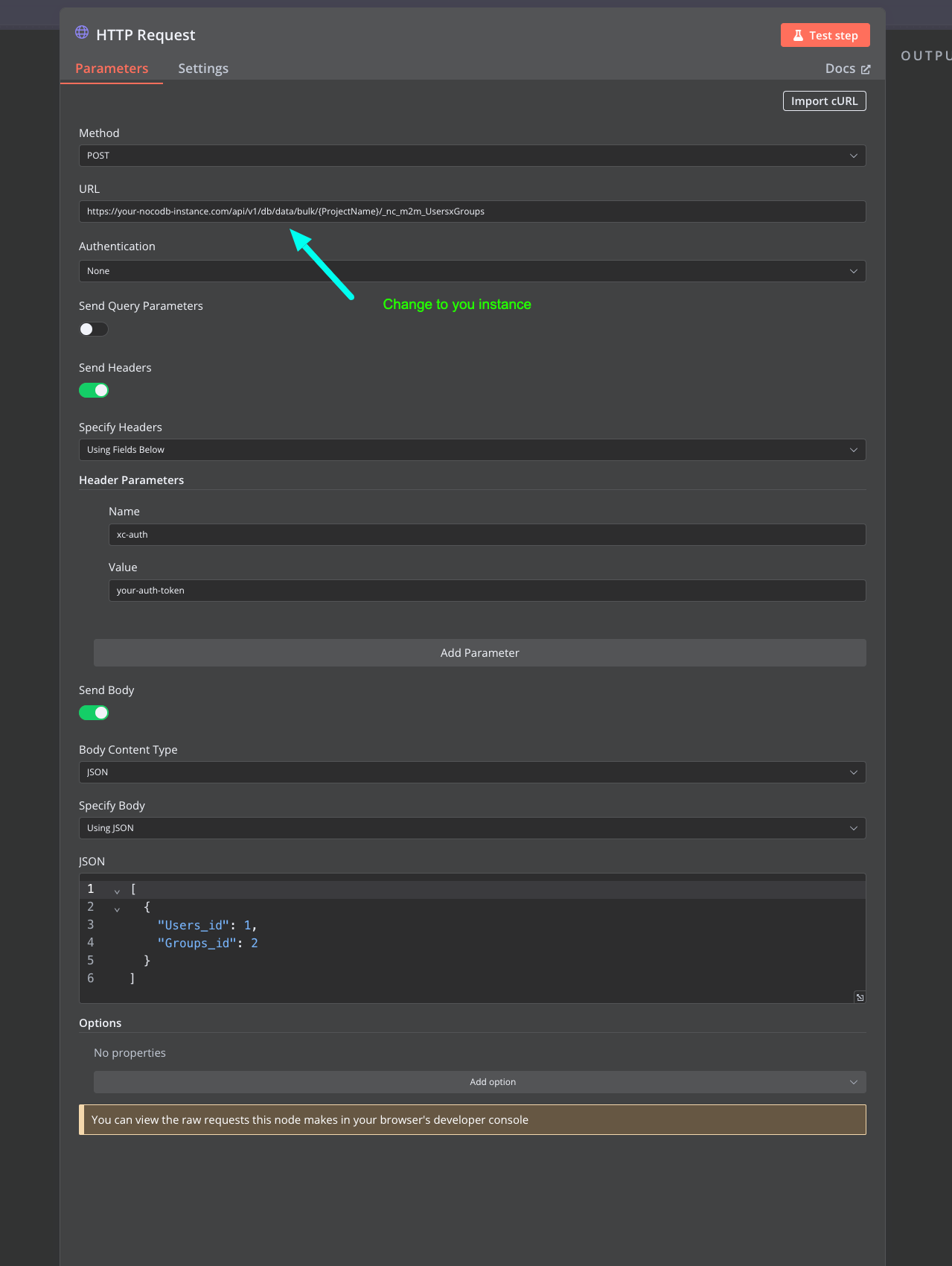

Hey @Julien_J to change a links in a table you should you custom API call since NocoDB node doesn’t support it yet unfortunately.
Here is example of that node.
Thanks @Ruslan_Yanyshyn .
In your example of node, I just see “HTTP Request” node but with no parameter or other things.
Is it normal ?
Oh something may have gone wrong when I posed, I just fixed it.
Same problem here. It would be great to be able to do it though the node directly.
This is slightly different using v2 API:
