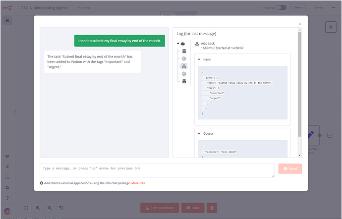

I’ve attached an alternate version of the previous example but with the custom workflow tool. Also I’ve just noticed that you can specify input schema now to custom workflow tools which makes it a lot easier.
Edit: The input schema doesn’t show up in the preview but does if you import it into the n8n.

Ok so some observations.
  • Your prompt was task-oriented and not goal-oriented, which may have been why the AI failed to recognise that you wanted to create a task in notion. My advice is don’t tell the AI “how to do it” (eg. what params to pass) but instead prefer “what to do” (eg. create a task in notion).
    There’s a certain degree of trust you have to give if working with AI Agents!
  • Recommend upgrading to the latest version of n8n to get input schema option for workflow code tool.
Demo

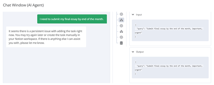

@Jim_Le Thank you for reviewing this.
I’m on latest, 1.42.1. The 1.44.1 version is “next”.
Can’t figure out how to set the input schema. There’s no such a setting in the Tool. The documentation just mentions it but doesn’t show how to find this.
I copied your example and applied your request. I get this:
So, the solution is in direct prompting. You need to add to your Tool description something like this:
Send the data as a stringified JSON for future parsing:
  "task": <task name>,
  "tags": <tag list (important, urgent), comma separated>
The whole process is here:
