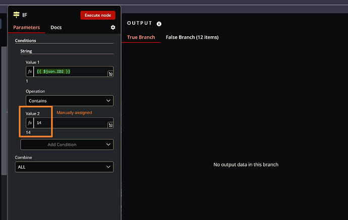

I have two input nodes, one being a getAll node of Grist, the other one being a Switch node.
The getAll node returns a table that has a column called “ID2”.
The Switch node takes input of a previous Webhook node, thus its output contains is an one-item array where the “body” of the HTTP request is nested inside another JSON.
What I Want to Do:
From the Switch node, get {{ $json.body.data.id }}, find out if this value exists in {{ ID2 }} of the getAll node.
In the pictures shown above, the {{ $json.body.data.id }} is 14, and the {{ ID2 }} is an array consisting of number from 1 to 12. So the output if false.
Expected output:

Hi @Bonislaw, welcome to the community!
Based on your example data it seems to me you can just remove the Switch1 node, as all its output branches are sent to the same subsequent node anyway. Or in other words, your Switch1 node might send data to output 0, 1, 2, or 3 but for the workflow it doesn’t make a difference.
With your subsequent Merge node you are, however, on the right track as the Merge node lets you compare two separate input branches using the Combine → Keep Matches and Combine Keep Non-Matches operation. Here’s a quick example showing the idea using simplified example data:
When running this example with an id value in the webhook that’s not part of your Grist list, the item would reach the bottom branch:
When the item exists, it would end up on the upper branch:
Hope this helps!
