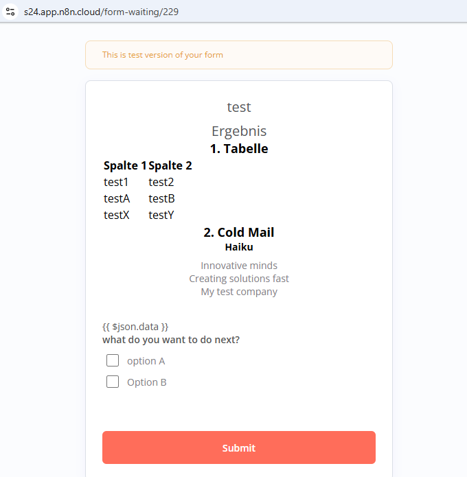

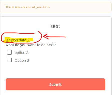

I tried:

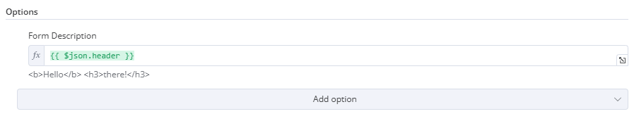

(a) the form node, but it seems that the custom html needs to be static / does not resolve java script expressions. (I manage to display custom text in the name of a form field, but this is text only and does not display links)
