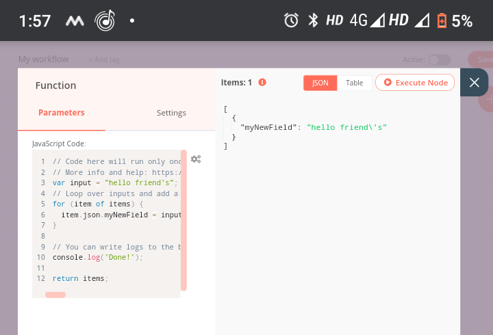

Yes. If it’s working then you can go with this approach. But recommended way is to use with Function Node. It’ll be more clear.
// Code here will run only once, no matter how many input items there are.
// More info and help: https://docs.n8n.io/nodes/n8n-nodes-base.function
var input = $node["Get comment info"].json["text"];
// Loop over inputs and add a new field called 'myNewField' to the JSON of each one
for (item of items) {
item.json.myNewField = input.replace(/\\/g, "\\\\").replace(/\'/g, "\\\'").replace(/\"/g, "\\\"").replace(/\n/g, "\\\n").replace(/\r/g, "\\\r").replace(/\x00/g, "\\\x00").replace(/\x1a/g, "\\\x1a");
// You can write logs to the browser console
console.log('Done!');
return items;
Please check the code and input variable value. I’m doing it from mobile. Quiet hard to check and format everything.
