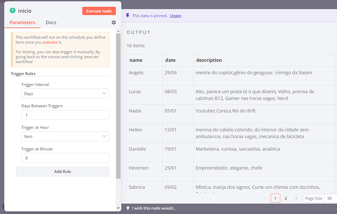

In this first print (which is also the first step) I force the “output”, in test mode when I click on “execute workflow” it works exactly with this output

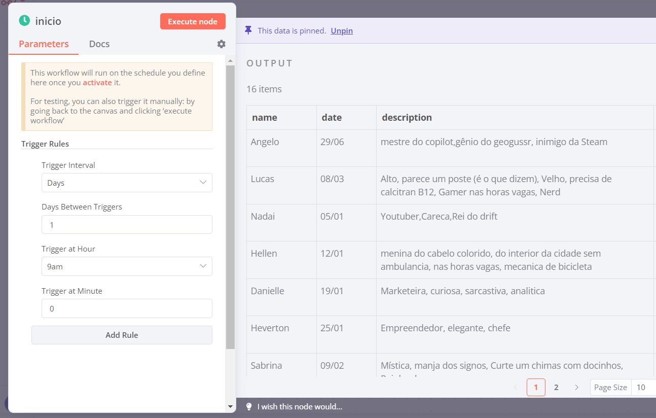

In the second, this is where I validate the other steps.

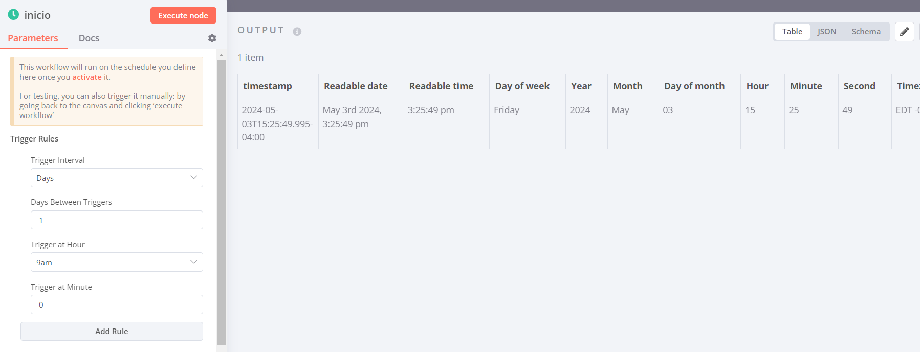

The problem is, when I “execute” only the first step, the output changes as shown below, which means nothing else works. Is there any way to pass this output or fix this data somewhere within n8n? without me needing to make a query or something like that in an api?
