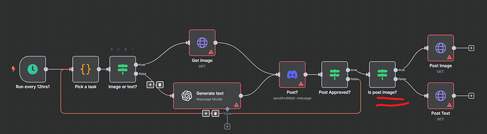

  • I have a workflow where if an IF node is false, it must re-run the workflow from scratch.
  • However, data from the previous execution is carried over and is still used once if node is passed again in the second execution.
My Question:
Is there a node or a way to reset the workflow (like it was never executed)?
Hi!
Try to use switch nodes!
Anyway, can you give me the example of n8n flow?

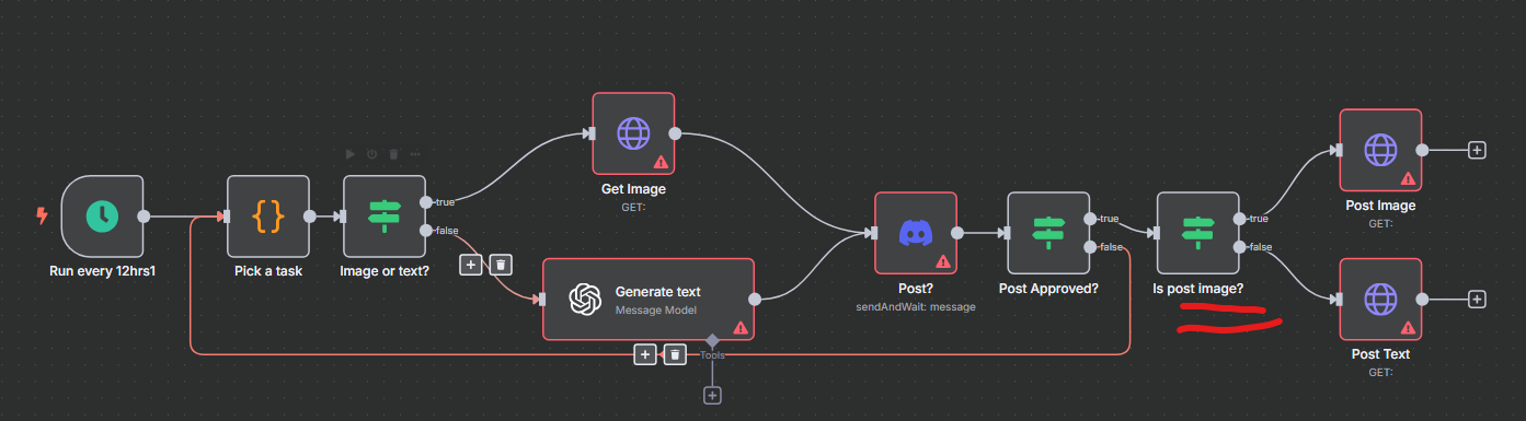

Hi @cutecatcode, thank you for your suggestion. However, I don’t think it solves my problem. It could be that I didn’t implement the switch node properly. I cannot provide the actual workflow, but I can add a sample workflow, similar to what I have been working on.
So here, if image branch is passed then declined, it will still retain the data. With that, it seems to not generate a new image on the second execute. Also, ‘Is post image?’ node will also be always true since i used ${'Is post image?'}.isExecuted.
Basically, what I’m looking for is a node or a way to re-execute node once Approved? node is false.
So, after declined, it should be restarted at ‘Pick a Task’, right? And to remove the item, you can use set in the middle node between Pick a task and Post Approved node, so when you try again, the data that already brings by Discord will be erased with the set node
