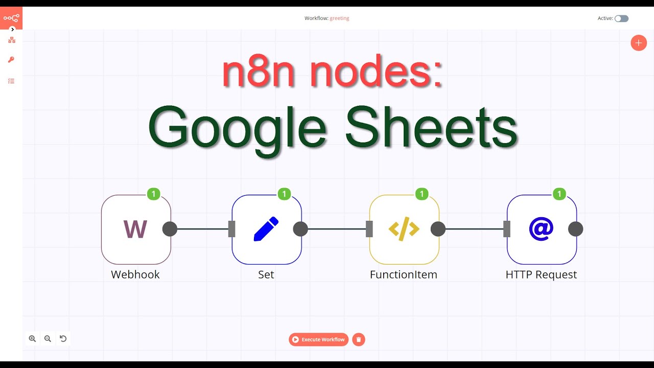

Looking to build a workflow using the google sheets node. How or where do I find the private key? Thank you.
You can find the video tutorial which @svenjanssen created about that here:
Or you can check out the tutorial about the same subject from Jovo which is also linked in the description of the credentials:
