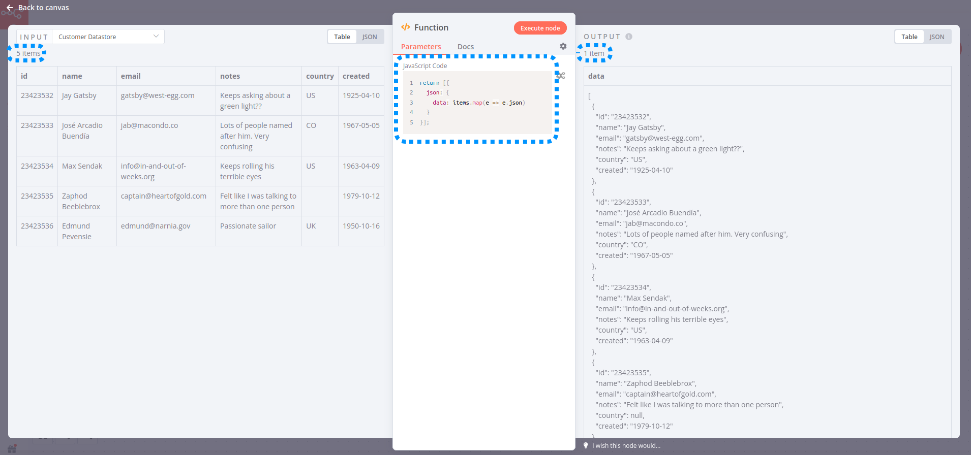

Hi @Eduardo_Pasquotto, unfortunately you didn’t mention which version of n8n you are running on your original post. Seeing you mention the Function node, here’s a quick example of converting multiple items into one I’ve put together on n8n@0.186.1:
It moves all incoming items into a single item with a data field:
Hope this helps!
Perfect, it will help a lot.
Thanks for the help, you are the N8N Jedi.
