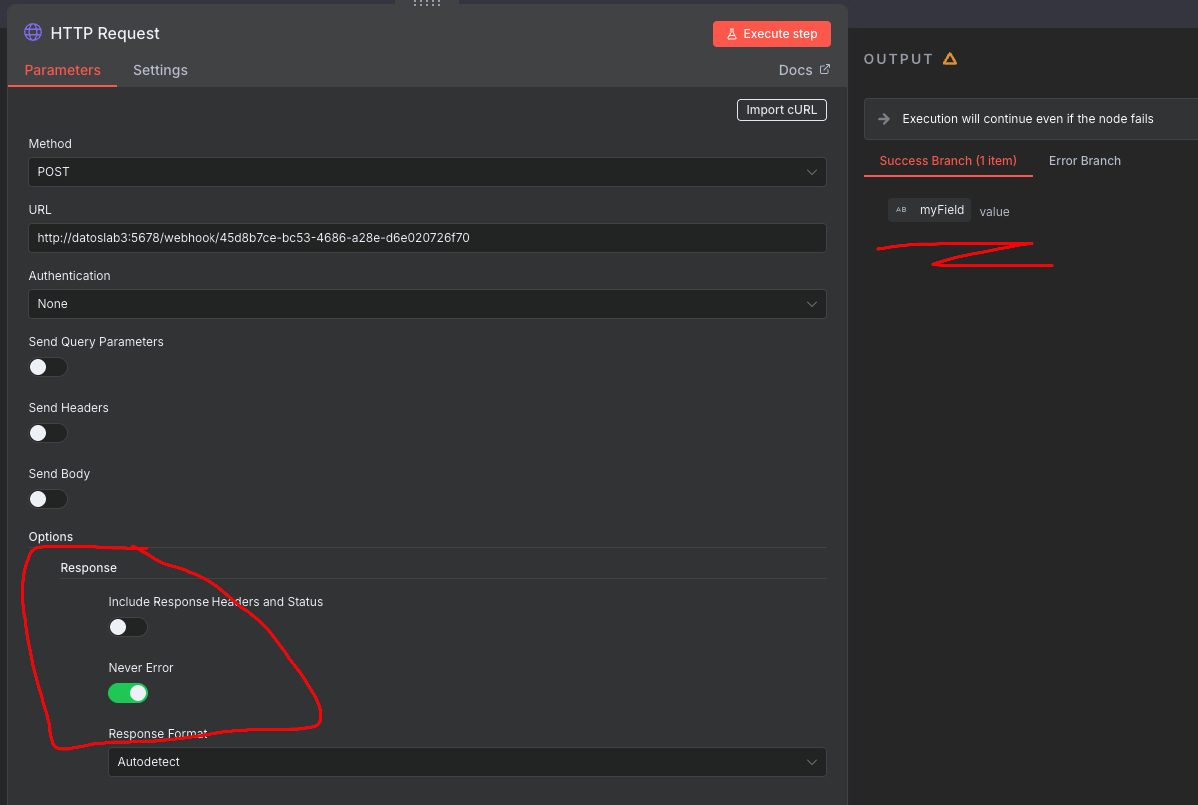

However, in the HTTP Request node, the JSON output does not appear to provide the data payload as a field. I would like to programmatically interrogate the data payload, in JSON format, to route/handle the error.

Hey @Eric_Shieh hope all is well.
Try to set “never error” in the response options:
Thank you @jabbson for your quick response, much appreciated!
