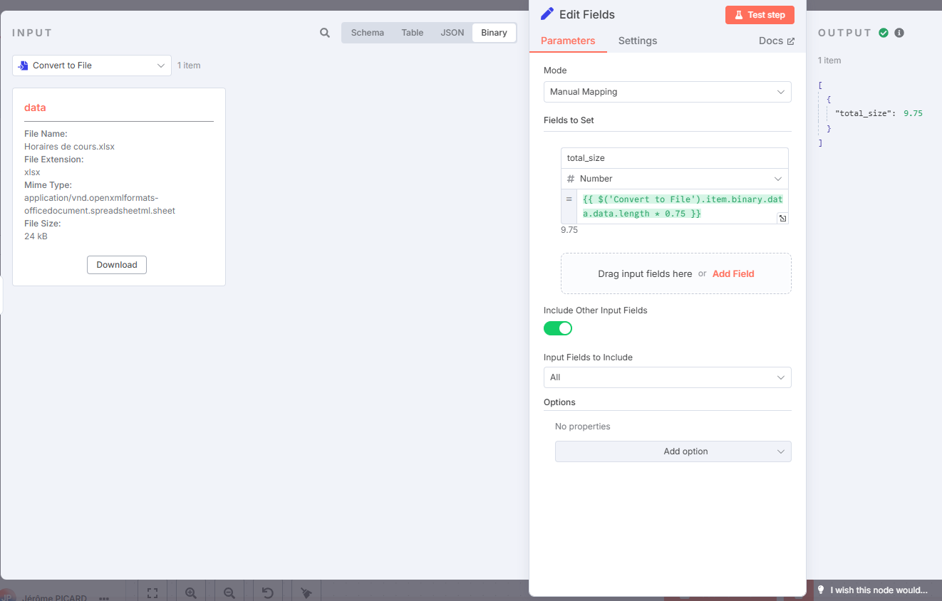

Hello @darrell_tw,
Thank you for your help.
I followed your suggestion, but unfortunately, it doesn’t work on my side.
As you can see in the screenshot below, the file size is 24 kB, but the calculated total_size value is 9.75.
Hello,
After some investigations, I have found a solution by adding a node code with the following instructions :
const buffer = await this.helpers.getBinaryDataBuffer(0, ‘data’);
return {
fileSize: buffer.length
