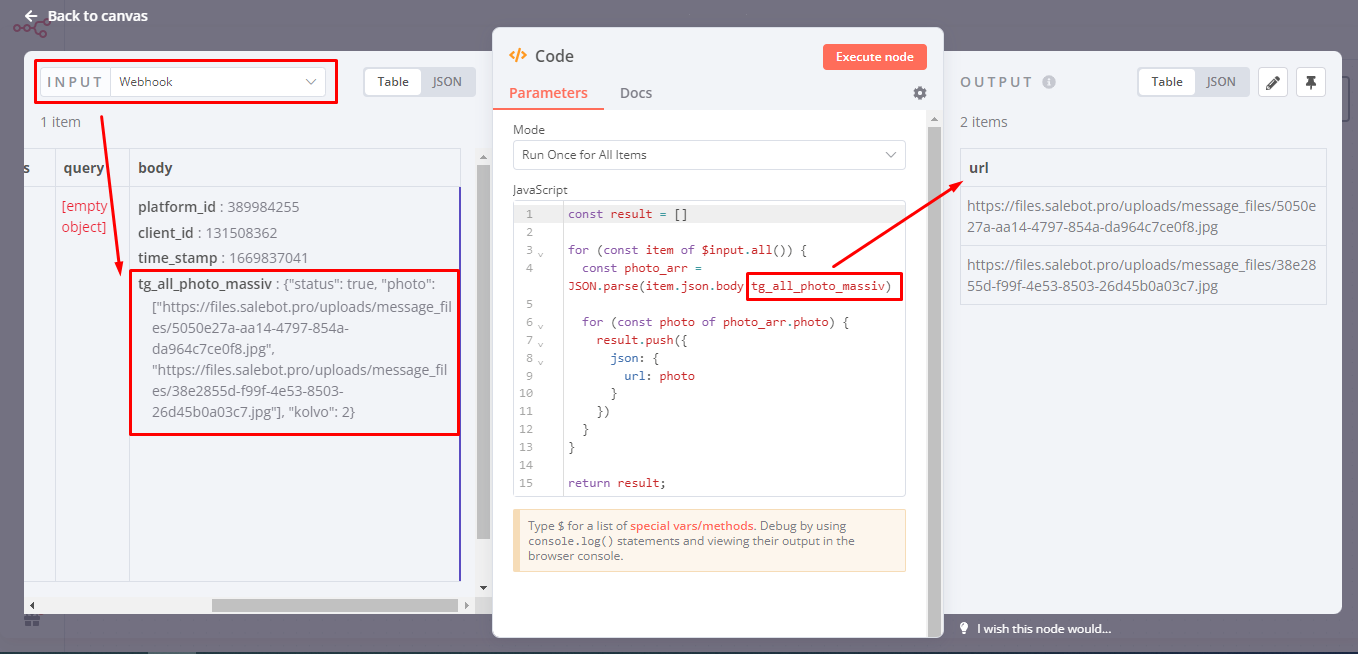

How to get to the webhook node via <Code>?
Previously, the node followed the webhook and the received data was converted to the format I needed.. now I need to change the location of the node.. but in this case, I don’t know how to get to the webhook node to get data from it
const result = []
for (const item of $input.all()) {
  const photo_arr = JSON.parse(item.json.body.tg_all_photo_massiv)
  for (const photo of photo_arr.photo) {
    result.push({
      json: {
        url: photo
return result;
tg_all_photo_massiv:{“status”: true, “photo”: [“https://files.salebot.pro/uploads/message_files/5050e27a-aa14-4797-854a-da964c7ce0f8.jpg”, “https://files.salebot.pro/uploads/message_files/38e2855d-f99f-4e53-8503-26d45b0a03c7.jpg”], “kolvo”: 2}
I am having the same issue. In earlier versions, you could pin a json which made all so much easier to test.
I’ve solved it by detaching the Webhook node (detach it) and replace it with a Code node exporting the sample data.
Then when I am happy with the flow, I activate and attach the Webhook node.
This bug is reported to @Jon
tg_all_photo_massiv - data gets here dynamically (((
Hey @Farid_Farkhadov,
Is the webhook node directly before the code node or is it a couple of nodes back?
Hi… Jon! a few nodes ago
You will want the options here: Built in methods and variables reference - n8n Documentation the workflow below shows a way you can use the output data of a previous node using the name.
