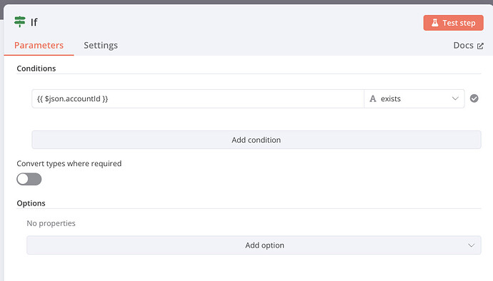

Below is the configuration in my n8n for:
You can add a code block like the following:
The code block will check if the output of HTTP request exists. If it exists, it will return that output, else, you can return a different output with the “default” accountId that you want. You can then pass this code block as an input to the Jira node to create the issue.
you should add a node to classify the output of http node, if it’s failure then you could set it as a default ID

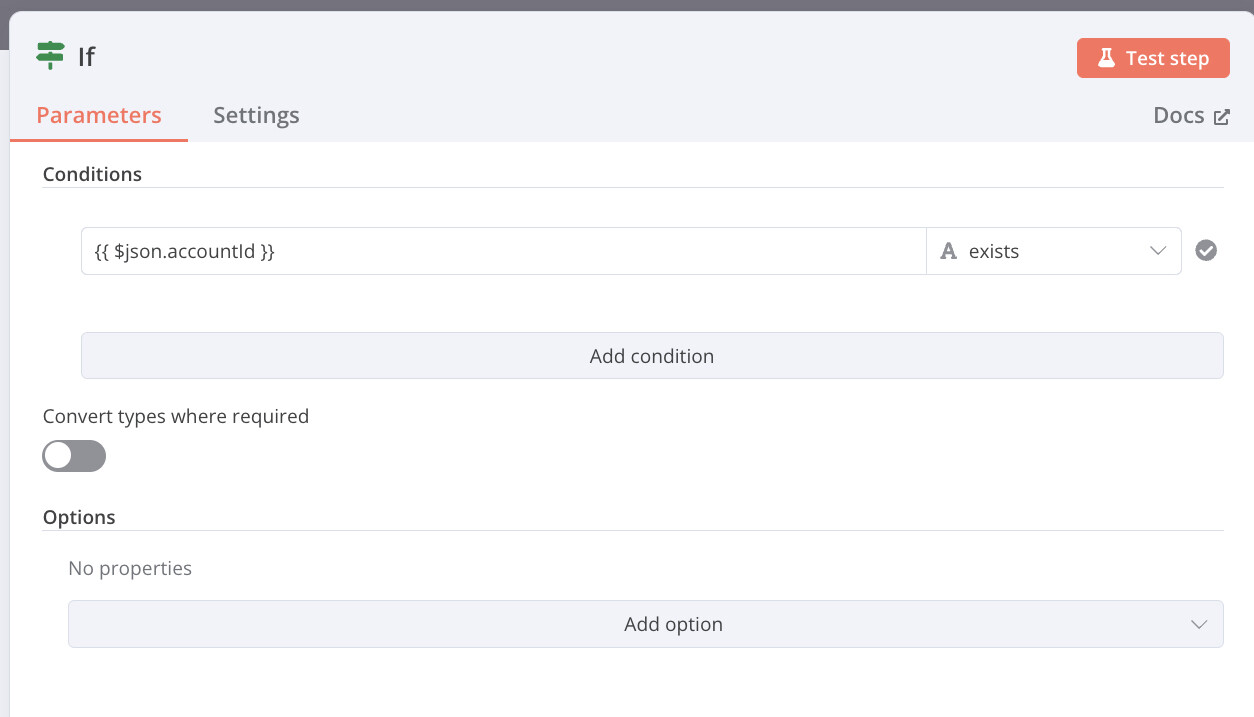

@hrishikesh I’ve set it up as you advised, but it only executes to the “HTTP Request” node. The subsequent nodes, including “Code” and “Jira create,” are not running and there are no error alerts as image:
Below is my configuration:
Apologies for the oversight. You’d have to enable the Always output data option in the HTTP request settings:
And then, try changing your code to:
