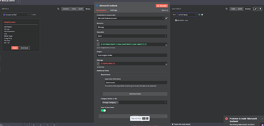

I’m trying to create a workflow that captures responses from a multi page survey. The responses then get calculated and turned into a Pie Chart which then becomes an Email attachment. (Up to this point, it works), Then want to replay the responses in the email body as a HTML table.

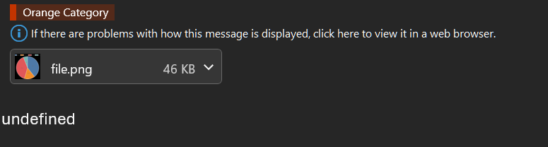

The error I’m getting
It sends an Email with an attachment from the workflow, but there’s nothing in the Body
Does anyone have any suggestions as to how I replay the the responses back to the respondent in the email body?
Thanks!
Hi @n8nnoob
The screenshot indicates that {{ $json.table }} is undefined. Are you sure about that? Could you please share what the JSON tab looks like?
I would like to suggest the following changes:
For the Code Node, it should only be executed after the Red Node. If not adjusted this way, the Code Node would run after each step in the form process, even if only the second or third page has been completed and not all values are yet available. This would lead to the creation of four separate HTML documents instead of just one.
Additionally, a Merge Node is needed before the Outlook Node. Without this, the Outlook Node would execute twice – once with the Pie Chart and once with the HTML document. If both are needed, it’s better to combine them using a Merge Node.

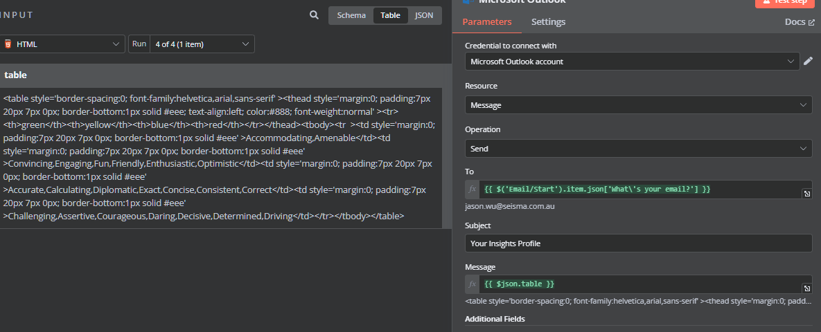

This is what was from the HTML output, hope that helps.
Hi @n8nnoob, I suggest following @Franz’s recommendations, as the screenshot shows you’re already experiencing the issues he mentioned—namely, the four HTML items along with the merge node…

This is what the output looks like though,
Am I doing something wrong with my Outlook Node?
I was expecting it to convert the HTML into a table with the responses.
:thinking:
I think you need to set “Message Type” as well

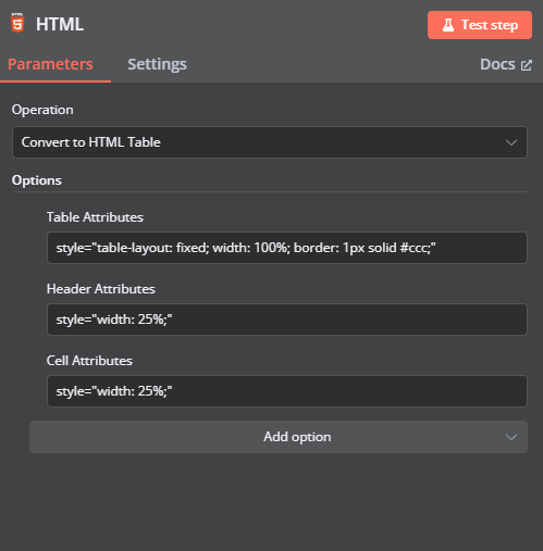

Yes, you can go with something like this
Table Attributes:
style="table-layout: fixed; width: 100%; border: 1px solid #ccc;"
Header Attributes:
style="width: 25%;"
Cell Attributes:
style="width: 25%;"
You can ask any AI to assist you to write these styles for you
@mohamed3nan
Thanks Mohamed, I wasn’t sure I tried to use the AI Transform tool, and it wasn’t being very helpful.

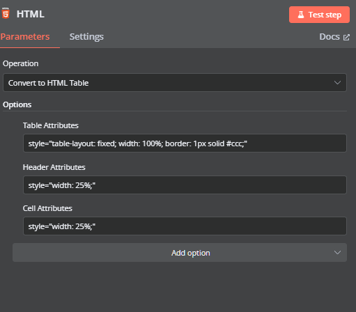

I did try what you said and i don’t believe it changed the table
Did I do something wrong?
Maybe the styling does not render here, send a test email

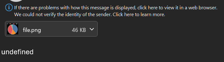

@mohamed3nan
I executed the test workflow from the beginning, filled out the survey, and it sent an email, received the attachment as well as the table, but the style of the table seems to remain different column widths
Above is a test email I just did.
Below is the complete current workflow.
Any Ideas?
Honestly, I’m not sure why the table style isn’t applied correctly.

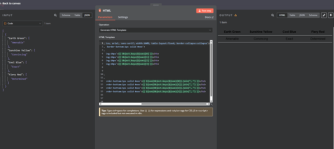

I replaced it with what you had, and still same issue being undefined
I’m pretty sure I updated it all to be the same
oh, sorry again, here is the html node
Thanks @mohamed3nan, you patient legend!
haha.
It works! Thanks so much!
