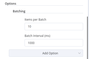

Welcome to the community @xuxiang!
That is possible with the HTTP Request node by adding the opion “Batching”:
Screenshot from 2023-12-30 21-38-17
