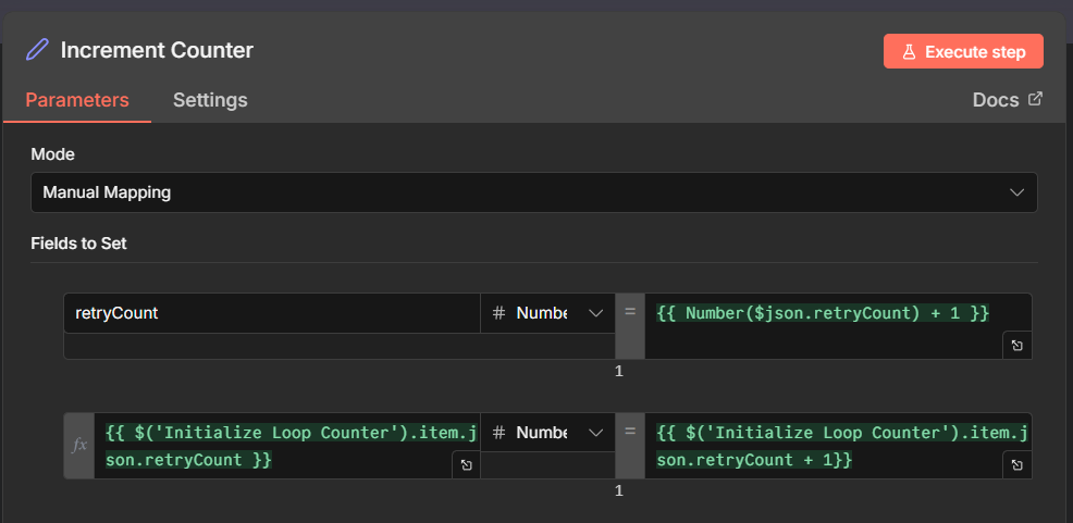

I set a counter variable “retryCount” to 0.
Und some conditions I wannt to iterate the loop once again at a maximum of 5 times. So I increment the counter. But on the beginning of the loop, the input variable “retryCount” is still “0” and has no change.
Both of this here doesn’t work:

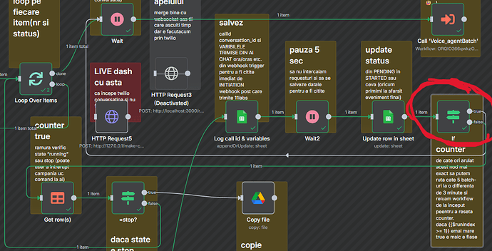

I think you can make use of the built‑in runtime variable $runindex.
If you want to check how many times a different node has run, you can also use that node’s run index in a Code node or expression, for example:
{{ $node[“Some Node”].runIndex }}.
In my case i just wanna know when a certain inner Loop has run morre than n times, so i can do something else(i am just restating calling an workflow).
Heres how i use the $runindex :
And here is rhe context :
So when the inner loop has runned more than n times goes to true.
