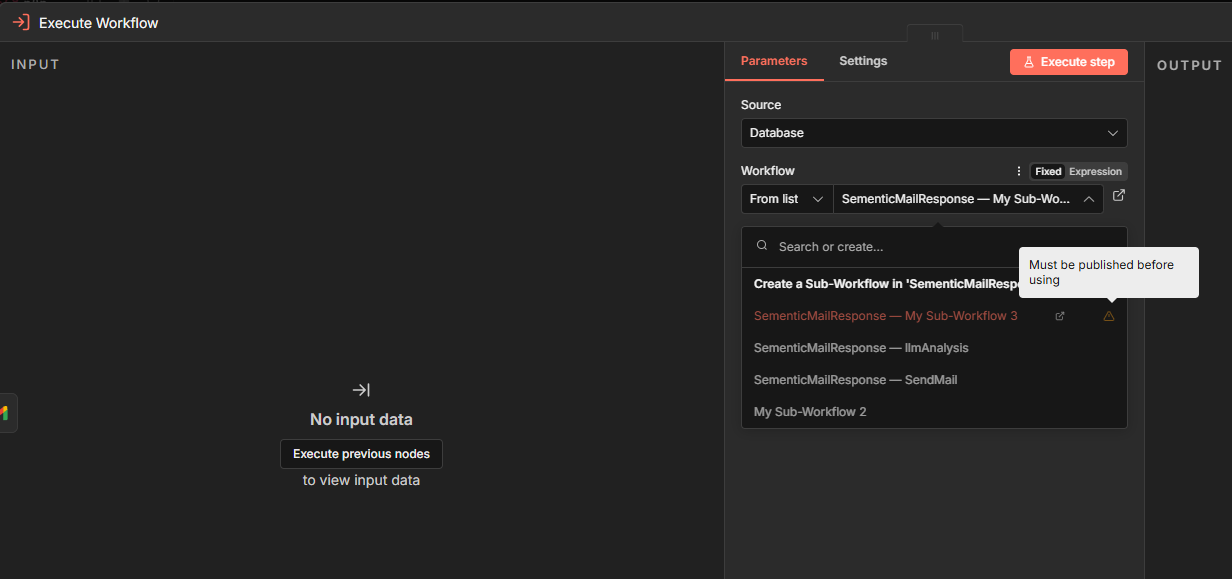

I am currently exploring the n8n using 14 day free trial. I build one small workflow and divided that workflow into sub work flow. but when i tried to call sub workflow from mail workflow. it is showing error “Sub-workflow must be published before using”.
What i understand currently, let say my main workflow is in production and i got the issue in one of the sub workflow. so my next step would be fix the issue, test it and then push it in PROD.
But due to above restriction how i can i test the changes end to end. Because once i publish the changes and prod bot execution is on going my changes would impact that changes as well.

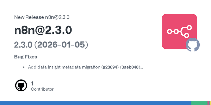

The pre-release 2.3.0 already provide the solution
You can modify your sub workflow in a production main workflow.
The production execution will only trigger published version.
Then your manullay execution will only trigger draft version.
