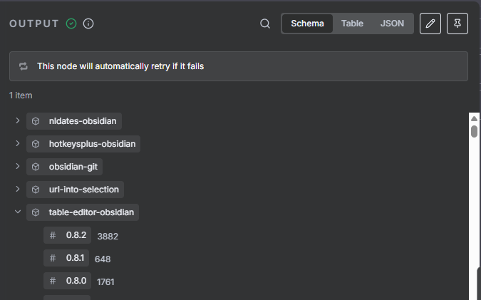

Below I have pasted an HTTP node that gets a JSON from a website. What I want to do is process it like a list with a Loop node, iterating each object in the list. The list contains objects, which are the names of softwares I am tracking, and each object contains multiple versions, and a date field called “updated”. What I want to do is go through each one, get the name of it and the updated date, and then after that I will run those through a Compare node to another set of data. I can take it from there. But the trouble I am having is converting this JSON set of objects into an iterate-able list that a Loop node will process properly.
  • n8n version: 1.110.1
  • Running n8n via (Docker, npm, n8n cloud, desktop app): Local/Docker
This is what the output of the above workflow looks like currently:
Just a single line.
And I want it to instead be something like this:
Split into a list of all the objects.
However I cannot use a Split Out node, because the output is flat.
I need something like this:
But not as a single output item, instead as a list of objects, INCLUDING the name of the object itself.
So that I can add a Loop node after that and iterate each one, to extract the software Name and the Updated date from it.
How can I do this?

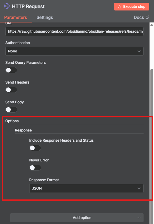

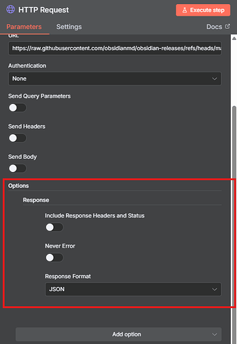

First, in the HTTP node, go to Options > Response and set the Response Format to JSON:
This will output the response as formatted JSON:

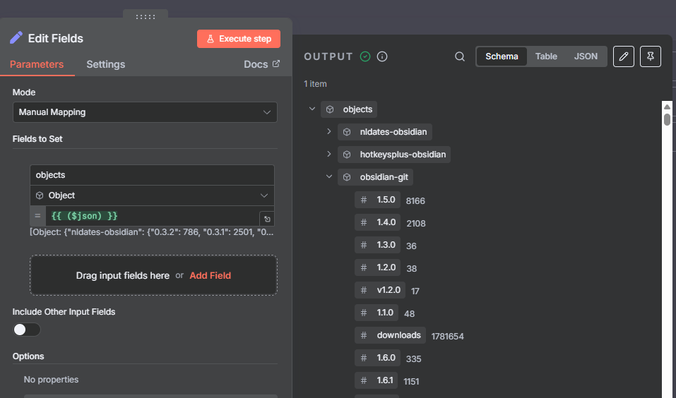

Next, use a Set node to assign the entire object to a field. You can then manipulate it as needed:

Thank you both for the reply. First I have set the HTTP node to Response: JSON.
@Gallo_AIA I am still learning how to work with objects vs arrays within n8n. I think conceptually what you said makes sense, however I am trying to use the Split Out node as you suggested but I’m still a bit lost of what node to put between the HTTP node and the Split Out node, my goal being to iterate through them.
What would a Code node look like for mapping objects into an array which includes the name and updated fields? If I had the end result to look at, or a similar example, I could learn it very fast.

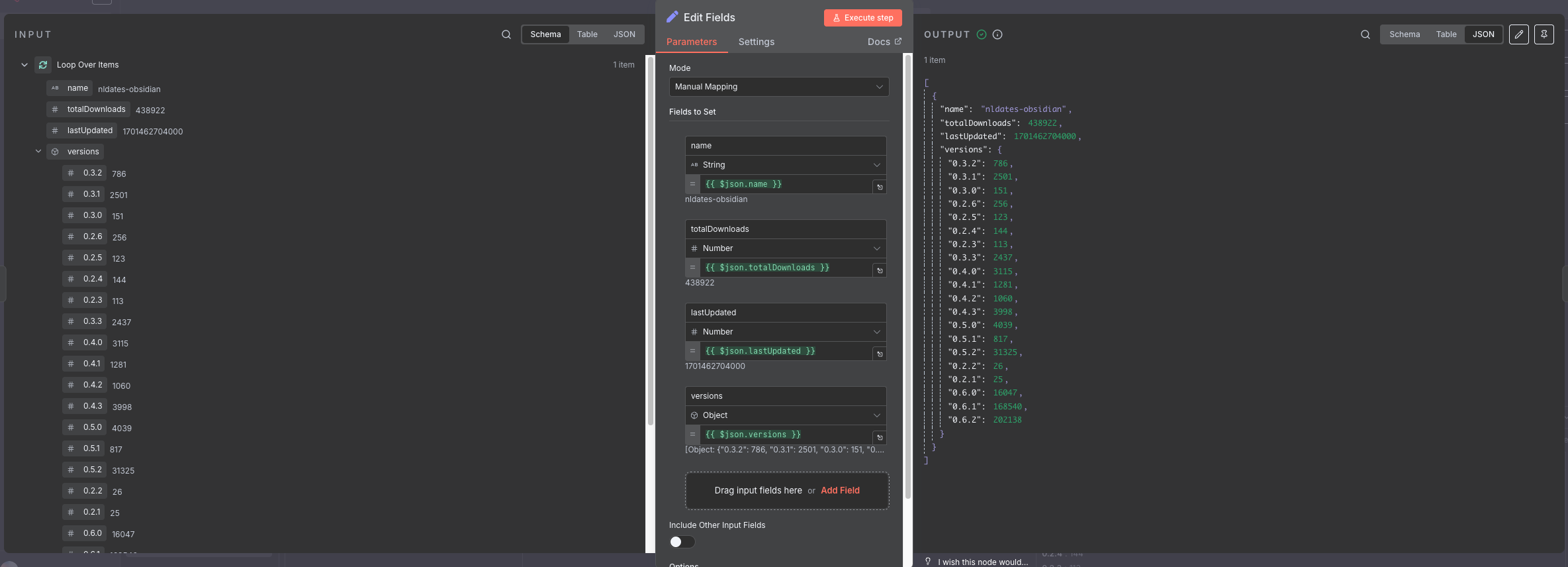

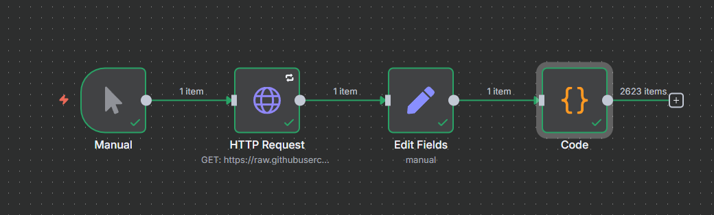

I added a code node right after the HTTP Request,
Then i can directly loop through from the return value of the code node.
I think there are some type issues in the code, needs to be optimized.

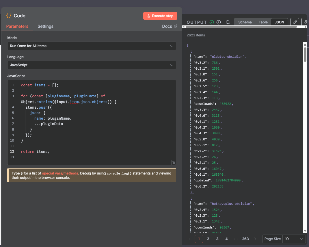

You can try this one:
@raybankless This looks very close to what I want! Would you mind copy pasting the Code node itself from your workflow in a reply? I tried to copy paste the code in your message into a Code node in my own workflow, but it gives me an error and I’m not sure why.

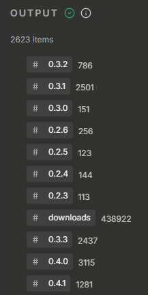

@mohamed3nan Your solution looks good too, however I would need one more step added to your Code node, which I don’t know how to do; I need the Name to be included in the iteration. Looking at raybankless’s screenshot above, I need it to look like this, so I can pull the Name and the LastUpdated dates out as I iterate through the list.
I don’t know if i’m copying wrong but this is how it works for me
"nodes": \[
“parameters”: {
“jsCode”: “const outputItems = ;\n\nfor (const item of $input.all()) {\n try {\n const parsedData = JSON.parse(item.json.data);\n \n for (const [pluginName, pluginData] of Object.entries(parsedData)) {\n const pluginObject = {\n name: pluginName,\n totalDownloads: pluginData.downloads || 0,\n lastUpdated: pluginData.updated || null,\n versions: {}\n };\n \n for (const [key, value] of Object.entries(pluginData)) {\n if (key !== ‘downloads’ && key !== ‘updated’) {\n pluginObject.versions[key] = value;\n }\n }\n \n outputItems.push({ json: pluginObject });\n }\n \n } catch (error) {\n outputItems.push({\n json: {\n error: `Failed to parse JSON: ${error.message}`,\n originalData: item.json.data\n }\n });\n }\n}\n\nreturn outputItems;”
“typeVersion”: 2,
“position”: [
560,
48
“id”: “c272686f-18d9-4b47-9a9f-2601618c633a”,
“name”: “Code”
“connections”: {
“Code”: {
“main”: [
“pinData”: {},
“meta”: {
“instanceId”: “727ad39836ca47a4a1b152e9a5fe1af7095e985063493ccd21ceb3dff6f01cf7”
I couldn’t upload JSON here so uploaded the whole workflow to drive
Hope this helps
@raybankless Yes that google drive link worked, thank you for doing that! Strange that the editor here wouldn’t let you do it. This is exactly what I needed. Thanks again, this helps heaps
