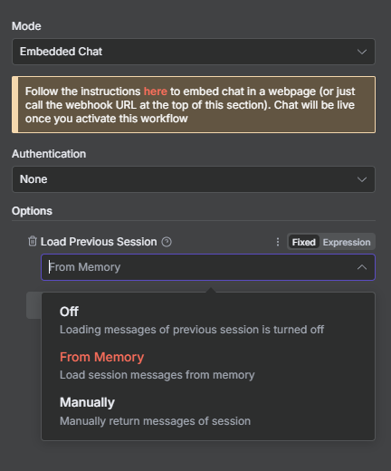

Since you’re storing the messages, you’ll just need to edit the chat node trigger, enable the Load Previous Session option, choose From Memory, and link it:
Then, pass the Key of the session you want. This way, it should load previous chats in the UI.

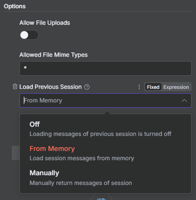

There is an option in the chat trigger node to Load Previous Session which i think is what you’re looking for..
Are you suggesting that I maybe go back to using the chat trigger instead of a web hook to kick off the workflow? That's how I initially developed the workflow, and was testing it, but then at some point I was directed (by chatGPT ;)) to use a web hook as a trigger...
yes try using the chat trigger node and configure the Load Previous Session option
OK, thanks a alot. I will go back to trying that.
Hey Mohamed, thanks again for your help. Turns out that the solution was as simple as you suggested!
I had wandered down some rabbit hole trying to use webhooks, etc…and manually writing and retrieving records to the DB, and then using all kinds of complicated script code in the webpage to try to retrieve past messages and insert them into the widget manually.
But doing what you suggested worked like a charm and was super simple to implement! So thanks again! :slight_smile:

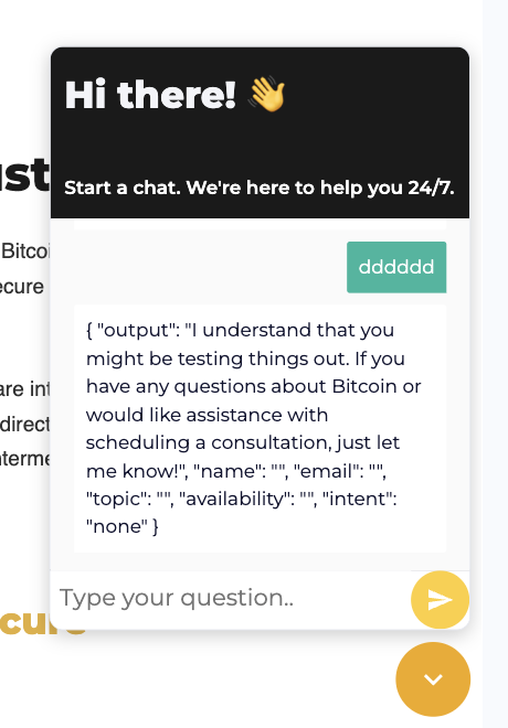

This is working great within the workflow, but it means that the agent is also storing past messages in the database in a format that doesn’t work well when retrieving past messages for a webpage refresh:
“content”: “{\n \“output\”: \“I understand that you might be testing things out. If you have any questions about Bitcoin or would like assistance with scheduling a consultation, just let me know!\”,\n \“name\”: \”\“,\n \“email\”: \”\“,\n \“topic\”: \”\“,\n \“availability\”: \”\“,\n \“intent\”: \“none\”\n}”,
Do you know of a way that I can:
a) keep data structured like this in the workflow so I can work with the individual fields, but
b) store just the plain text of each message in the database so that when history is retrieved, the messages are formatted in plain text?
this is an example of how the history is displayed when I refresh the page
