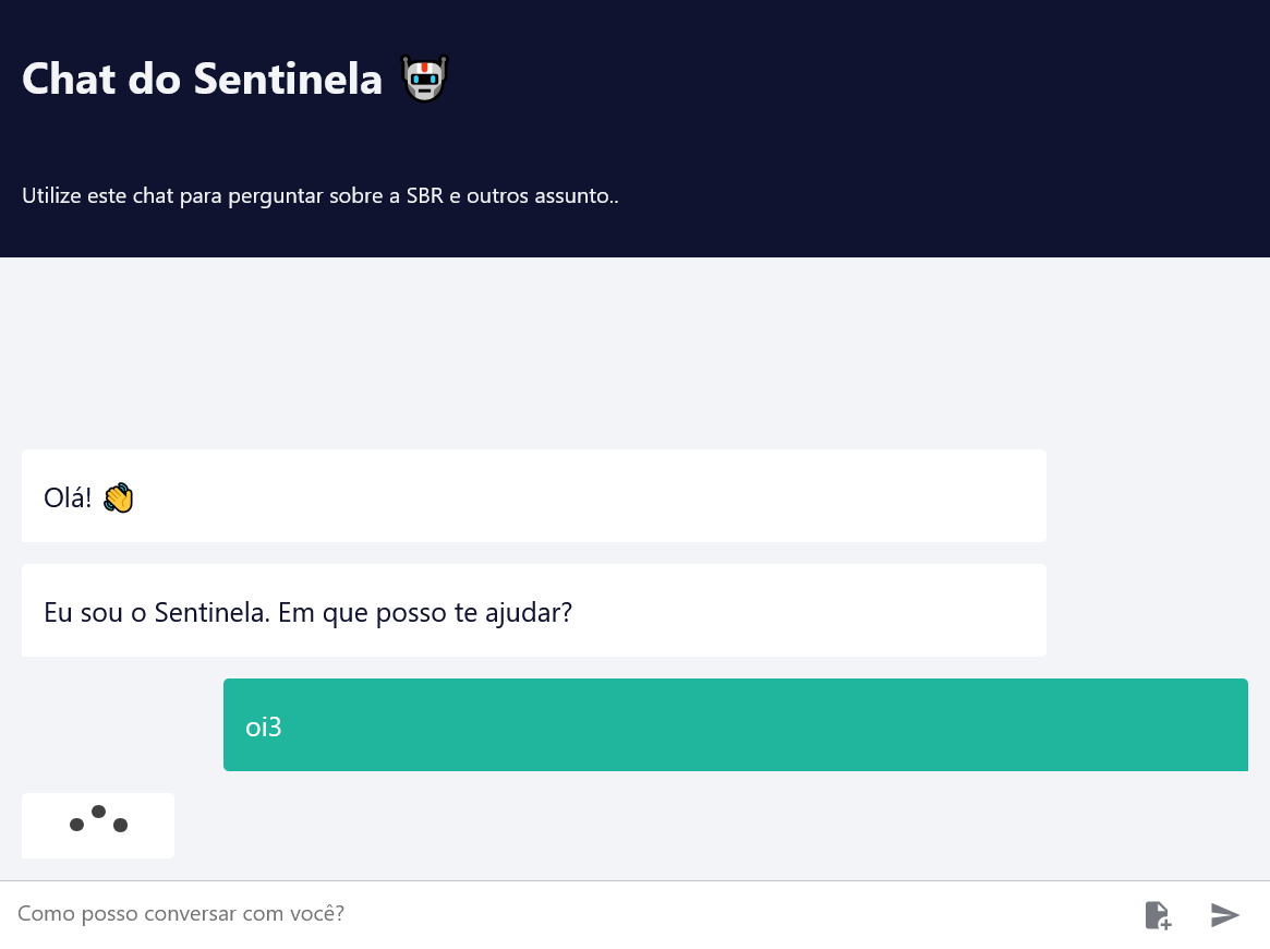

I’m trying to make a chat trigger go public, but not being able to.
My n8n is self hosted in an aws ec2, and the instance is accessible through a domain, through IIS.
Testing it inside the n8n, it works ok. But when I access the Chat UI, public on my domain, it doesn’t respond anything, as in the image below. Also, no execution is registered.

That’s why I can access the Chat UI through my URL in any PC (example: http://n8n.mydomain.com/webhook/webhook code/chat).
I’m thinking it might be some problem related to IIS (Windows Server) or in the AWS EC2 configurations, but couldn’t find it so far…

@Gabriel_Yuji_Nakashi @Thomas_Yung
I would advise, in a scenario like this, once on the url itself, to open chrome/browser developer tools, and investigate the console & networking panel.
Then try perform chat actions and see if there are any crazy errors. I have seen something like this happen on self hosted where the websocket was dropping connections, and I had to custom route the socket endpoint via nginx reverse proxy, and it fixed the issue.
