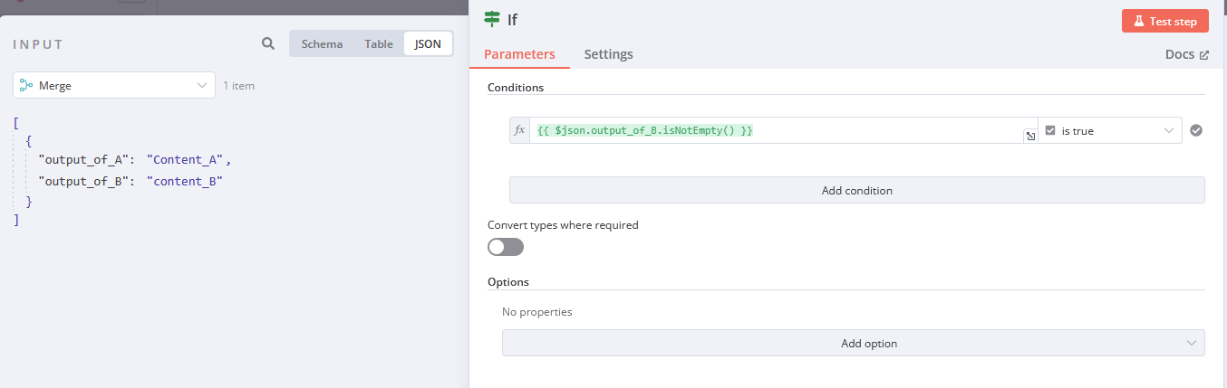

Instead of appending the objects of A and B in the merge node how about combining them by position? That will leave you with an object containing both outputs A and B (for each run). Then test B for emptyness and proceed like so:
