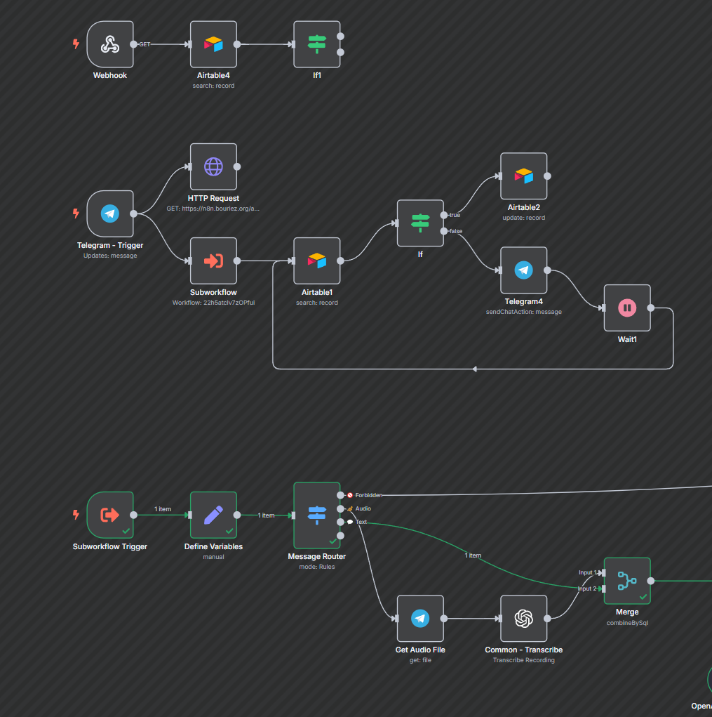

Hello, I am trying to accomplish the same without success.
I have a simple workflow for a little AI Assistant, it can take up to 1 min to answer with.
I wanted to persist the send_action in a loop until the end but it looks like the workflow is not running nodes in parallel.
Could you help me ?
ps: I had to cleanup the real workflow for the post
maybe using sub-workflows
Here is a parallel execution example:
You need to use sub workflow exactly like [Jim Le] suggested
Hello, so i should move the main logic (ai, tool, etc.) in a subworkflow and keep the loop with the send action in the main workflow ?
If you want, though, it’s optional—you can include multiple workflows within a single one. Just copy the [Jim_Le] example workflow, play around with it, learn how it works, and then tailor it to your needs
Thank you, I got it working, I used airtable also since I had no idea how to share data from a workflow with another without an external solution.
I have the main workflow starting the subworkflow with all the logic, and then running the loop.
