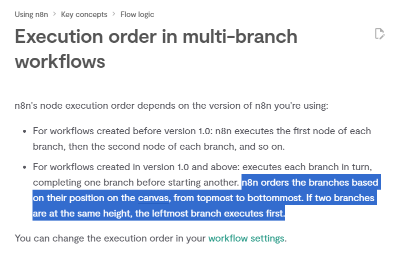

Multi-branch workflow follows an execution order from top to bottom.
Meaning a branch from the top will execute before the one in the bottom.
During testing that doesn’t happen, but during execution every branch gets executed.
So theoretically you could retrieve values from nodes that are not in the same branch.
But ideally you want to pass data to the same branch. Because you could lose the items reference if you mess up the data (see item linking).

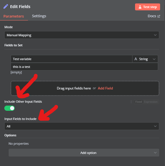

Connect everything in a single branch, instead of separating them.
Like this:
The “Edit Fields” node allows you to pass previous data forward:
That way everything arrives at the final destination, but triggers the final node only once per item.
Let me know if that solves your problem! :muscle:
